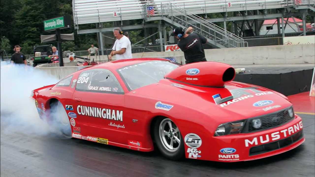

prostock scoop!!
dysan
Dis-Member
Aug 11, 2007
3,902
11
Williamstown, N.J.
Can't have one of those since I still run 10.0 index. They are cry babies in the index classes so I'll need a more "normal" scoop or a cowl. I also want to be able to see the other lane when I have to be in the left lane.

booo!!

It would also look retarded on a car only going 10.0. If I was running in the 8's then maybe. It's actually really difficult finding a scoop to work on our hoods since they start sloping down quickly. Most scoops & cowls are flat for a longer length than our hoods are.

I've looked into the bug catcher intake but a good one for a dominator carburetor is around $1500 if I remember correctly. I also can't use that harwood scoop for the same reason that it won't be allowed in 10.0 index.
