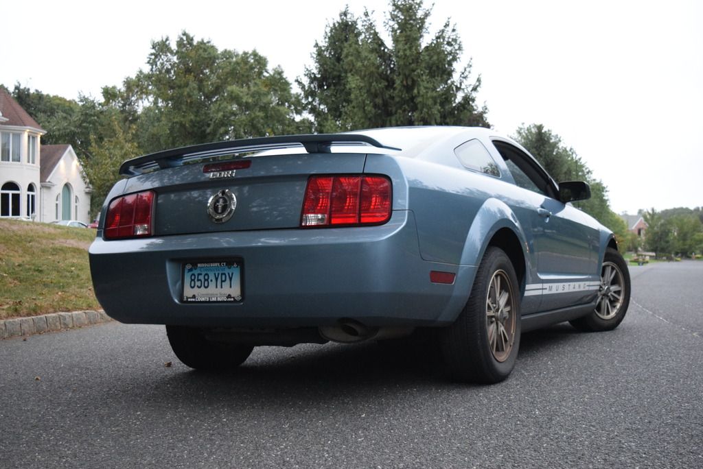

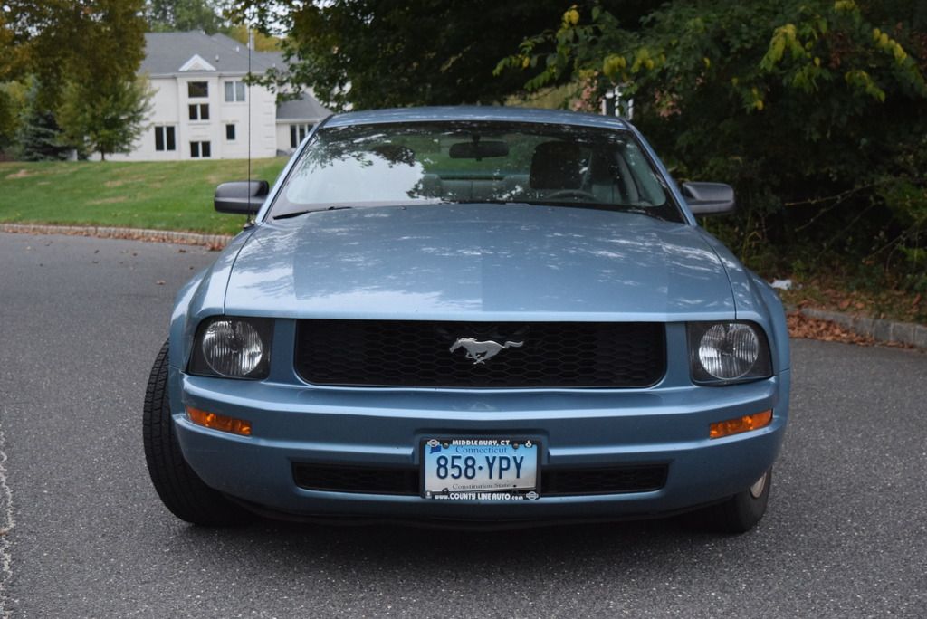

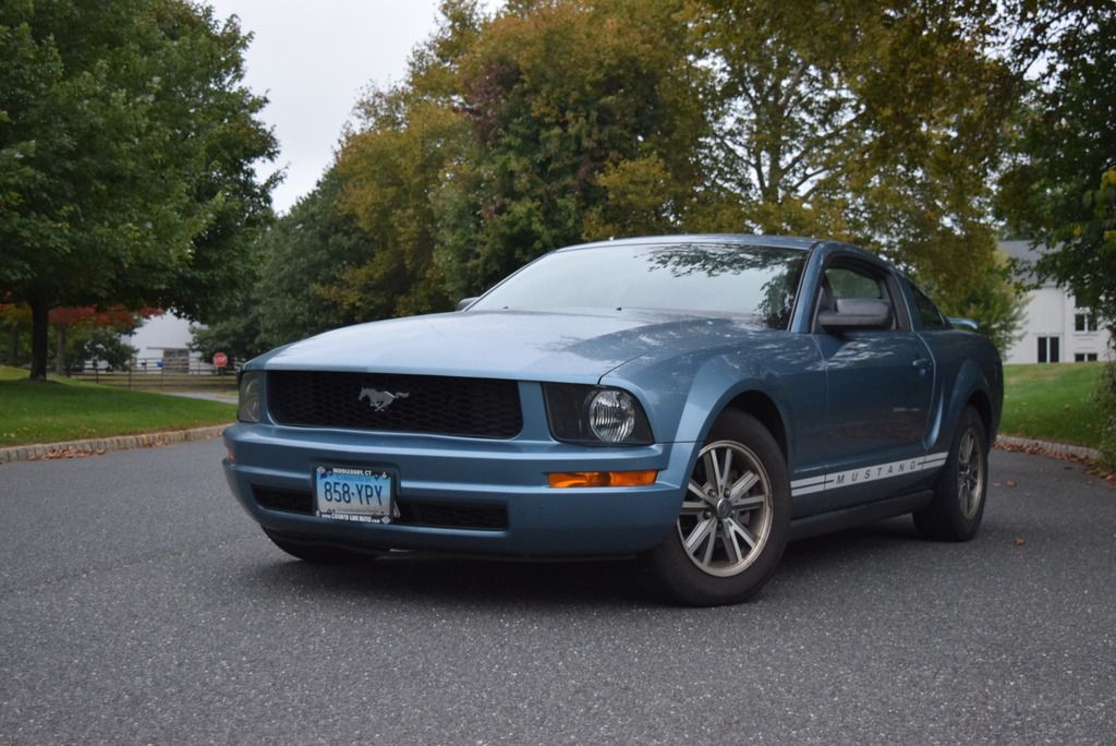

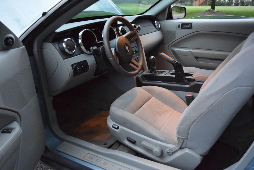

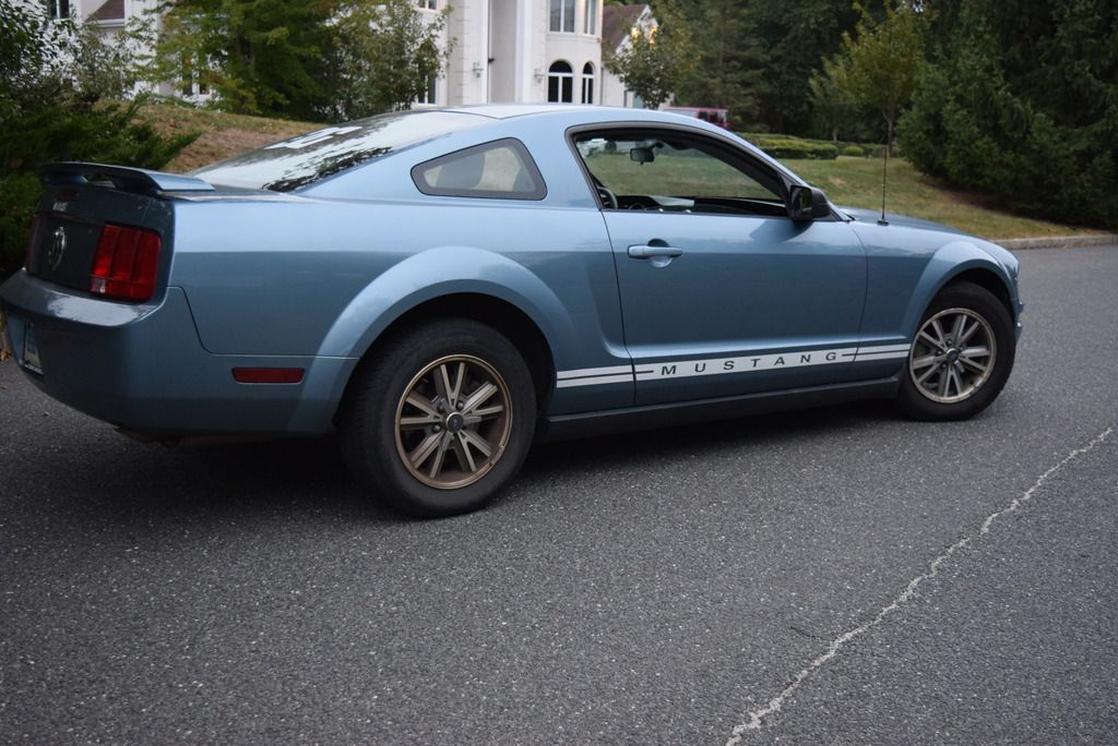

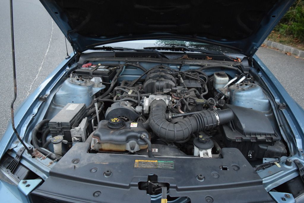

I wasnt planning on buying this car until the Coyobra sold (if interested PM Me), But this car came into my lap and I couldnt refuse.

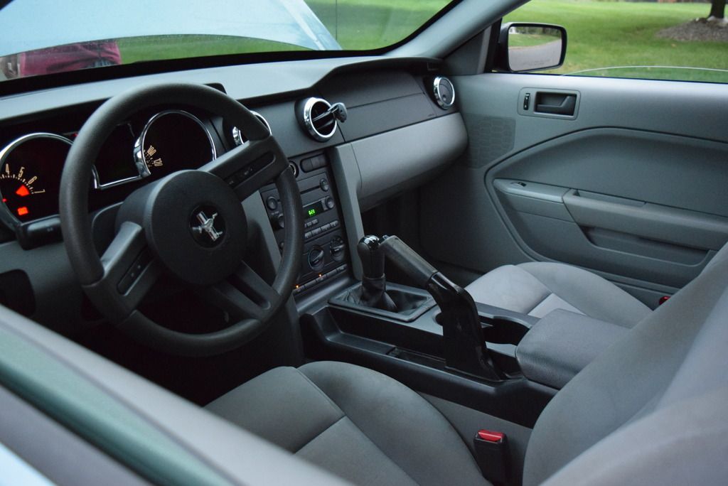

Its a 2005 V6 Mustang with a Manual. Straight body and only 2 owners!
Its gonna be a fun build

Well I was able to get some of the interior Gutted today and the new removable steering wheel installed!
I think both turned out really well-
Threw the seats back in until I get the bracket for the race seat ordered.

Then it was to pulling out that V6-
Finished off the night with starting on the oil pump gear install-
