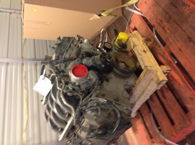

I can see why guys go with the Control Pack, trying to use the coyote PCM can be difficult because of the PATS system. In the S197 the PCM supplies RX and TX signals for the PATS but in the F150 it comes from the BCM, well I didn't get the BCM so I had to wire things to make the starter relay engage and Power the PCM a little differently. I got back the fuel pump with the modified fuel hat for a fuel pressure return, my buddy welded it in so tomorrow hopefully it fires up.

Are you going to run it on the stock tune? With a control pack tune file, it may not do a PATS check. It doesn't with a Mustang PCM.

I did get a hold of Lund, I will have to send the PCM off to him but he will be out til next weekend. I tried emailing Lito, haven't heard back from him, I've used his tunes before with success but I think that the only way to bypass PATS is to have a correction made to the PCM, not sure if this can be accomplished by just an email tune.

As long as you use the control pack tune, you shouldn't need to send off the PCM. The control pack tune doesn't look for PATS.

Thanks, I appreciate you talking to him, I've used his tunes before, never had a problem. I am using the F150 PCM and harness. I did speak with Lund and he said he can program the PCM, turn off the PATS, make the auto pcm think its a manual but not til next week and he wants me to send him my PCM. To me it seems like it can be programmed to not look at PATS without sending it off.

Update: I sent the F150 pcm to a known tuner who supposedly could delete the PATS, after shipping it to him, paying $250 and getting the pcm back, I plugged it in, hit the key and it started, ran terrible and was in limp mode, no throttle response.I was pretty pissed at this point, the pcm ran the F150 perfectly before the motor, harness and pcm was pulled. I attempted 3 times to get in touch with Mr Tuner guy, he would not respond to any emails. Thank God for The Parts Farm, they sold me a pcm with PATS deleted out of a 2011 Mustang and it runs great ! I still have a few bugs to work out, got the speedo working yesterday ( thanks Dylan). My 2014 EPAS rack still doesn't work, also have to figure out why the GENMON signal is not getting to the pcm, alt charges fine but the pcm doesn't see it.I also need to wire the a/c up, I was thinking about getting the Coyote a/c transducer and pigtail and wiring it up to the pcm, seems like it should work. For the record the Coyote motor I have with a few mods has more pulling power than my cammed out 3V motor with all the bolt-ons.
