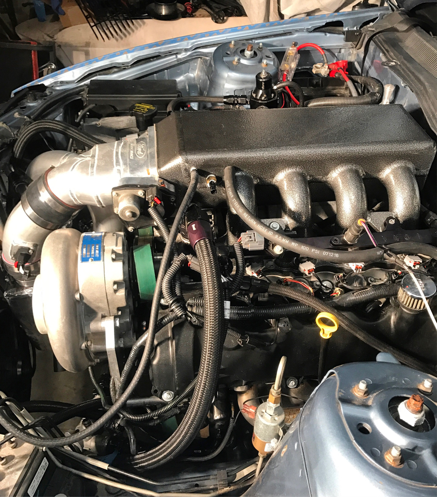

Finally back to working on the car. 5 weeks till first race. Got the new oil pan in,!oil feed/drain done for the blower. New filter relo kit on. Got the flaming river manual rack back in and reconnected the steering.
Waiting on a new coolant tank. I couldn't find a place to mount my old tank with this setup. Just have to connect lines once that's in.
Then on to a lot of wiring. Trans/intercooler pump/ radiator fan.

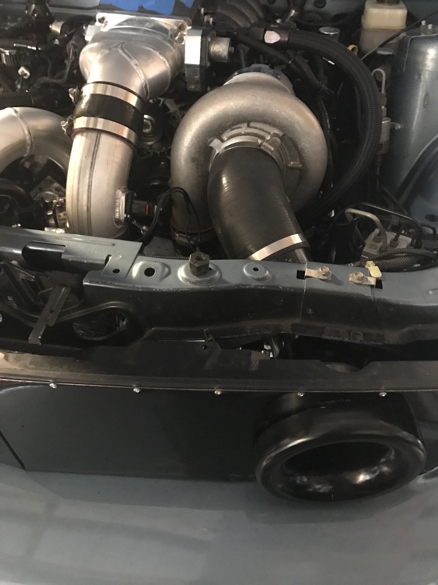

MAF in a curved section of pipe is interesting to me!!

It's as the base of the curve. We are going to see how it works. If it's noisy I'll just build a new pipe.
...Or you could just straighten up the turbulent flow with this:

Normally that's a no no, but that curve doesn't look too bad. Not like it's a 180 degree bend or anything close.
Yeah I'm hoping it'll be fine. Worked with the guys at Fathouse Fabrications on building this setup. Hopefully works out.

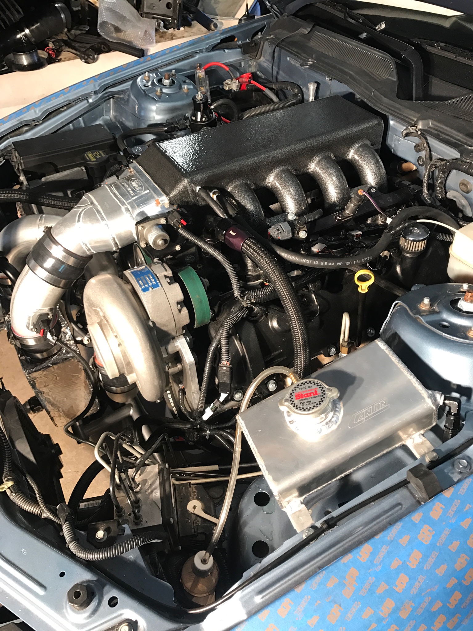

Got my new coolant tank in. Had my buddy cut the fittings off and weld AN fittings on it. Also extended the mounting brackets a bit.

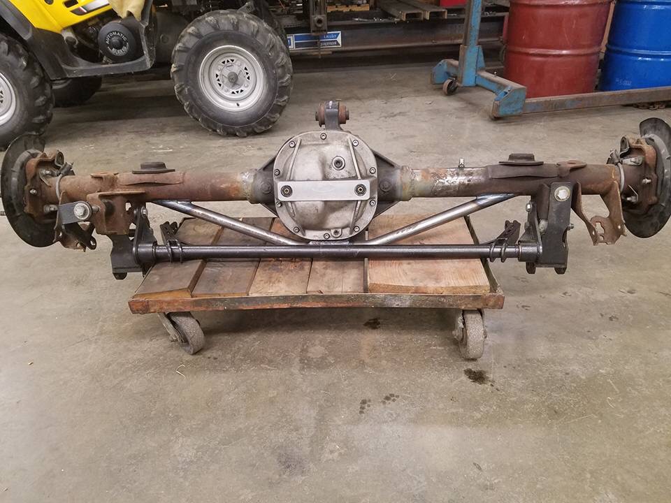

Making good progress on the car today. Rear end is back in. Just needs new brakes put on. Cooling system is done and filled. Trans cable is done and feels ok. Never shifted an auto before so not sure. Going to lay out my trans wiring. Installing a small fuse box in glove compartment next.
