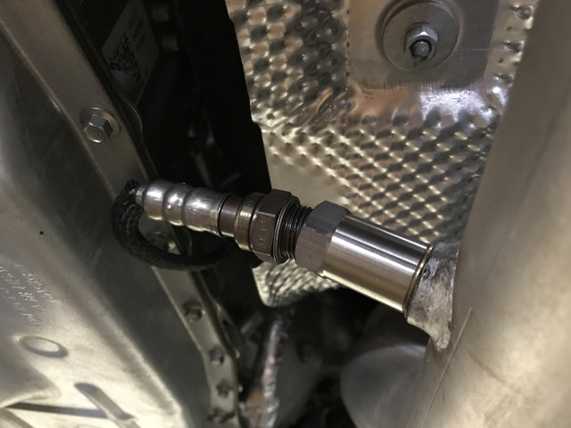

Well these are going in over the weekend. Put the smallest jet size in and have some red rtv gasket maker on there to hopefully keep the rattle down.
Should be easy minus getting the O2 connectors unsnapped. Those were kind of a pita iirc.
Riptide
Will work for Mustang.
Oct 27, 2009
5,248
17
Montucky
Long story short. The vibrant defoulers are not going to work. I was able to get the driver side on but the passenger side won't fit. Transmission pan interferes with it. Part of that is because lethal welded the bung on there in a spot that is angled slight up towards the car. If it were on there straight it may have fit.
So back to the drawing board now I guess. I could try one of their J style defoulers instead.
PS: I wasn't able to disconnect the O2 sensors either. There isn't enough room to get a hand up there.
