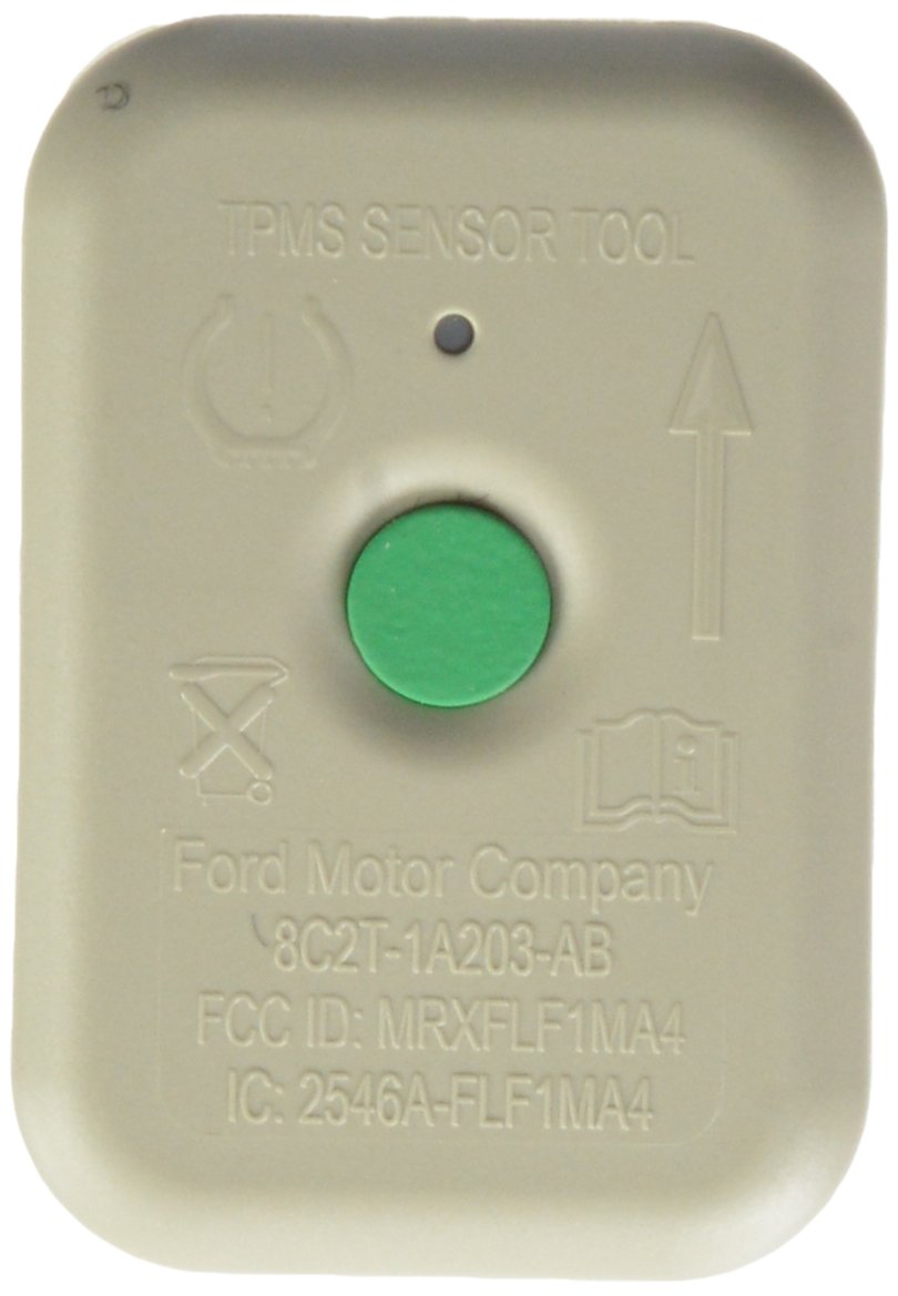

My light was on for the last few days, rear tires are at 27.5 cold, fronts at 32.
Today it got into the 80's, we reached 90 degrees for a few hours, light has been off most of the day, I'm assuming because the heat made the temps go up a little.
I've run the rears at 28 psi with no light but as soon as one goes to 27.5 the light would come on.
I don't think there's a factory setting, I think it has to do with whatever pressure the sensors were last trained to.
Do you have a TPMS sensor learn tool? They're about $40 from Tire Rack.

No, don't have a scan tool, but could be time to invest. I assumed that once sensors were trained, it was for whatever pressure level they were calibrated to at the factory.

The TPMS sensor remote is $31.45 on Amazon with free shipping:
Amazon.com: Motorcraft TPMS19 Remote Tire Pressure Sensor: Automotive
I'm on it. Thanks for the link!
