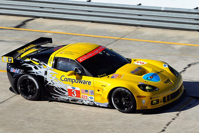

Yes, we're talking about the same thing, just with differing degrees. That TR hood does a good job of venting the underhood area, and meets the rules of the classes it was designed for, but it isn't perfect.
The C6.R reverse ducted hood is what I'm talking about. The radiator is rolled forward and a semi-sealed duct is mated to it and the hood. Makes for better front downforce and more cooling. When tied into a real front splitter design it can make big improvements.
Sorry, I'll quit going out on this tangent...
Now this is what I want to do! This is like the red beast correct?
