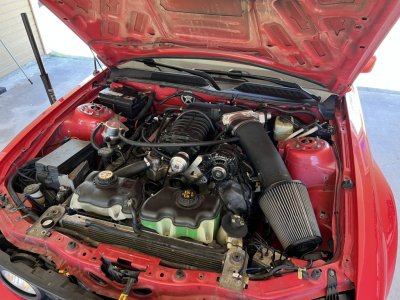

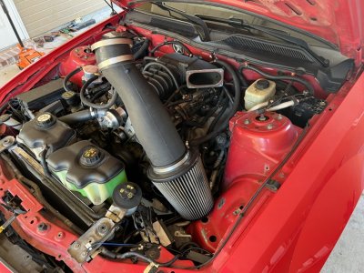

Random pictures from the installation:

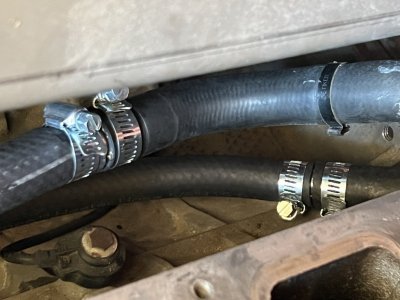

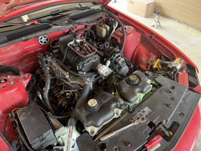

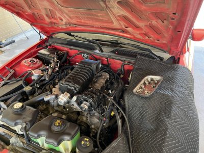

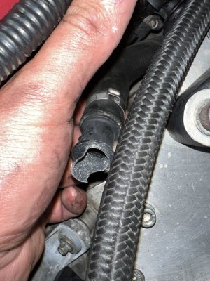

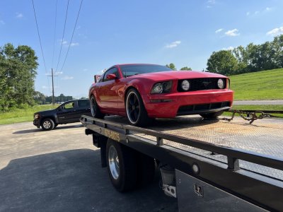

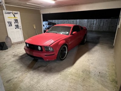

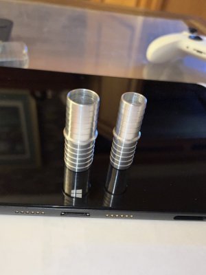

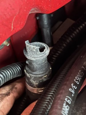

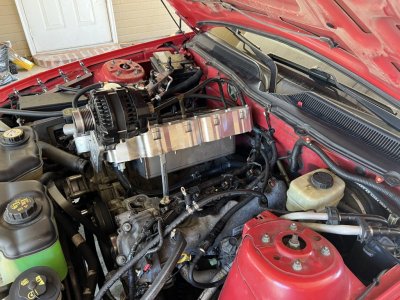

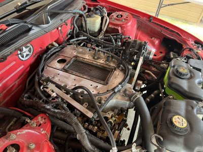

Back on May 11th, the fitting that joined two hoses together ruptured and she went home on a wrecker truck.
This should’ve lasted longer than five years! Naturally, it runs underneath the intake and won’t be a quick fix. I’ve decided to change both fittings so this doesn’t happen again.
ICT billet fittings for the win
Going to tear it down tomorrow and hopefully it’s the last time until a built short block goes in.

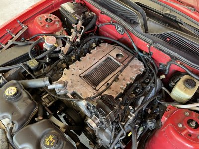

white95
boost or bust
Jun 8, 2009
2,014
130
Prairieville, Louisiana

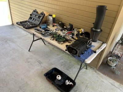

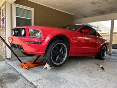

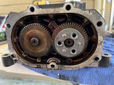

Start to finish it took about 5.5 hrs to tackle the job.
Yes, that’s a wrench acting as a kick stand. If it’s works, it ain’t stoopid
All of this to put hoses together without worry.
SMH.
Jason really does sell a nice product!

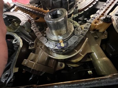

Changed the snout coupler and the crankcase oil while I was in there.

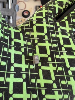

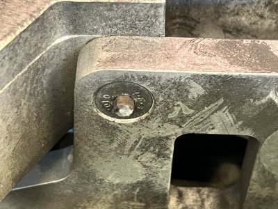

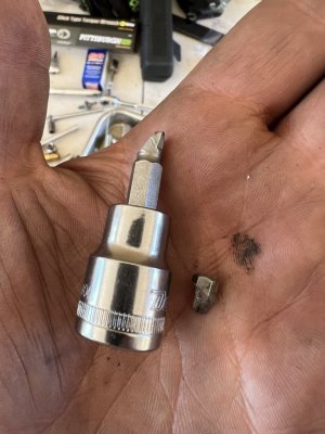

Everything that went wrong today:

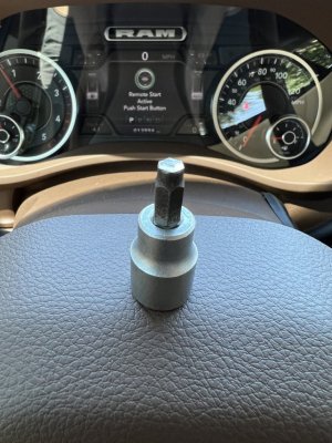

Broke a 5mm Allen socket
A49B0909-0DF3-493D-BAC1-6C38DFBDA938.jpeg FCBB94B1-863C-403F-AE02-B6F1E9923B17.jpeg 5B88251F-28D5-4EC2-8FBC-D650E5776DC3.jpeg
Broke the REPLACEMENT 5mm socket

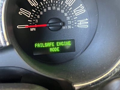

TB went full retard
A7E388A1-0B8C-4672-B42F-0400EF1D08D8.jpeg 1C79B2EC-B3C2-4C62-8097-668AC7B0E8E3.jpeg 1A603BDD-B0A9-4957-B97C-34A36E90C2A6.jpeg
Took the motor off the TB, reset the spring and it works.
For now.

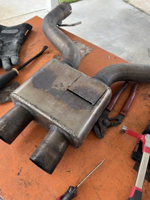

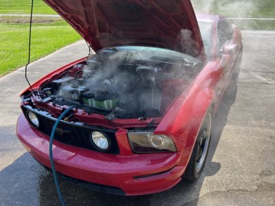

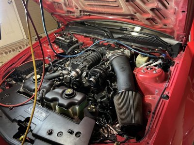

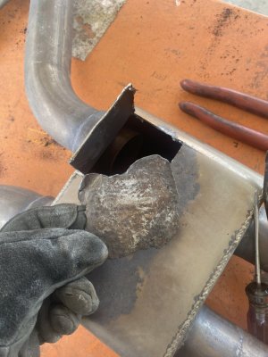

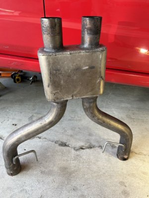

Fast forward to this week, another piece of the Prochamber came off and started to bounce around in there. The plan is to replace it with an x-pipe and then switch the MAC axleback out for some MBRP street mufflers.

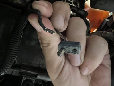

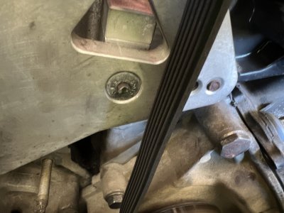

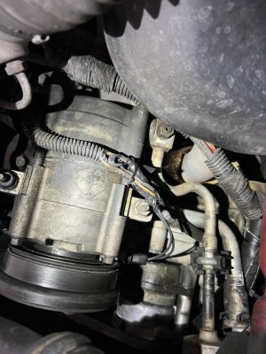

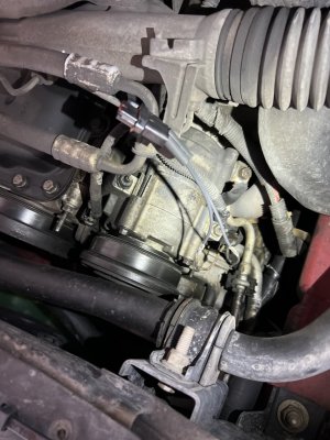

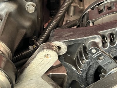

So, today was fun. Damn gremlins tried to shred the belt. Initial assessment looks like the ac compressor harness connector came loose and was pulled under the belt. Shredded two ribs closest to the engine and demolished the harness connector. Luckily we noticed immediately due to the belt slapping the piss out of anything in its way and the AC stopped. We limped it back to Reed’s house to get his truck.
Fucking Mustangs!!

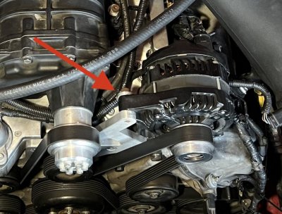

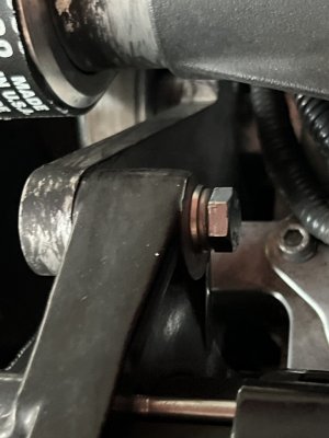

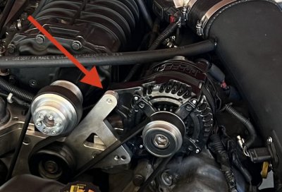

After getting the car home this evening, I popped the hood to let it cool off and to take a closer look for damages. Quickly discovered one of the alternator bolts was missing so the damn thing went on a walk.
This evidently allowed the belt to walk enough to begin the self destruct sequence. When enough of it begging flapping around it beat the crap out of the AC compressor harness which explains that.
F6BB9BE5-349F-4F4D-BEA2-41168CE8BE77.jpeg F72FF7AA-15E5-4780-A332-CFE5367B7977.jpeg 40AEE49E-F8B7-4490-A007-1A4739A4A1C0.jpeg
This was May 2nd:
This was May 28th:
Well, this is today:
All is well, for now.

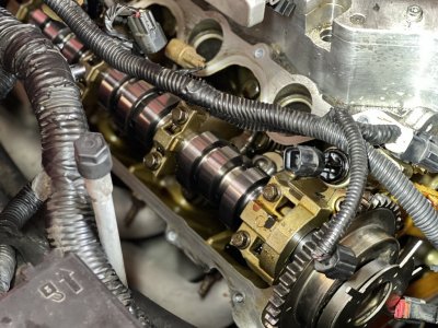

Well, except for the VCT solenoid that I suspect is causing some phaser knock on the passenger side. Sucker sounds like a total bucket right now.
