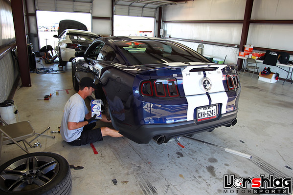

What's that other 1% of driving (that isn't DD) look like?
There's probably a suitable Carbotech pad - check their site for selection guidance. FWIW, even their lower-level XP track pads bite at least as well cold as Hawk's HPS. Cold meaning ambient temperatures at least as low as high 30°'s F. Their 1521's and AX6's should be even better (cold).
Norm
Agreed on these recommendations 100%.
There is no perfect street/track brake pad. Track pads are noisy, dusty, and don't work as well cold. Street pads are quiet, work cold, dust less, but don't work hot.
For a "99% street car" that means you aren't pushing the car on track, right? Like "noobie green group" going 70% full speed? If so the AX6 is probably the best bet. If you do want to push it on track try the lower XP pads from Carbotech, like XP8 or XP12. They will dust more and make some noise, but not as bad as the XP20s.
Hawk HPS and all EBC pads are better left to the non-enthusiast bargain hunters. They are low end pads.
For real track use the first things you need in a Brembo equipped Mustang are GOOD brake fluid, better flex lines and real pads. I cannot count how many Mustang folks take this for granted - we've changed dozens of pads and done dozens of fluid changes at the track before, but there's not always a crew like this at all HPDE events.
