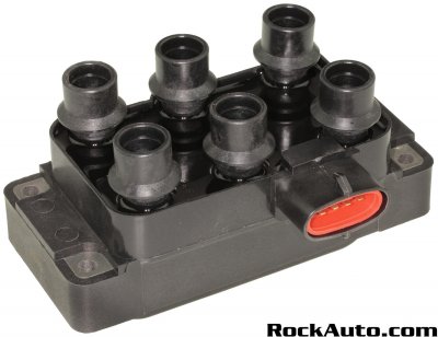

Rockauto lists a traditional coil and plug wires for the 4.0.
Also the spark plugs are an open ground strap design and not like the 05-08 3v plugs.

That raises a valid question. I was assuming we were talking about a 4.6 V8, but we may be talking about a 4.0 V6.
Is this a V6 or V8 car?

Well...... egg's on my face. Totally missed the post was in the 4.0 section.
Yes wires are probably worth it. If it's old enough to warrant plugs it should get wires too. No VCT to worry about on the 4.0, so ignore what I was saying on that. But the seafoam wouldn't be a bad idea.
