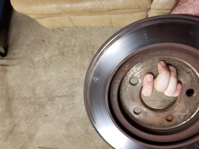

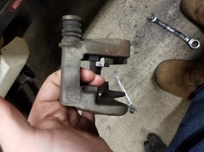

May 3, 2017 #21 leviathon forum member Joined Apr 28, 2012 Posts 449 Reaction score 0 Location Erwin, nc Thanks Norm, Here it is Attachments 20170502_203208.jpg 479.5 KB · Views: 13 20170502_201949.jpg 481.7 KB · Views: 12 20170502_201931.jpg 487.4 KB · Views: 11 20170502_201811.jpg 499.5 KB · Views: 14
Jun 28, 2017 #22 E EdwardGT forum member Joined Apr 13, 2009 Posts 63 Reaction score 0 Like someone else posted, I would've guessed that the heat was the symptom and not the cause. I had this happen once when I had binding in the guide pins. New ones fixed the problem.
