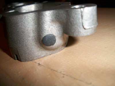

I'm working on mine now. I'm using quik steel. I drilled holes so when I put the quik steel in the main shaft hole. It pushes out of the holes I drilled. That makes a tab that will keep the plug in the shaft hole. I will try to take pictures of it.

This is the end hole, on the outside where the quik steel pushed out of the hole that I drilled. I smoothed it out to make a tab.
What an excellent idea! I'll do the same. Thanks for sharing Styre! :thumb2:

i used quick steel also... worked great. also remember that u need a fresh tube cause if it has hard pieces in it when you start throw it away or exchange it cause it will crumble when it dries... i know this first hand lol
