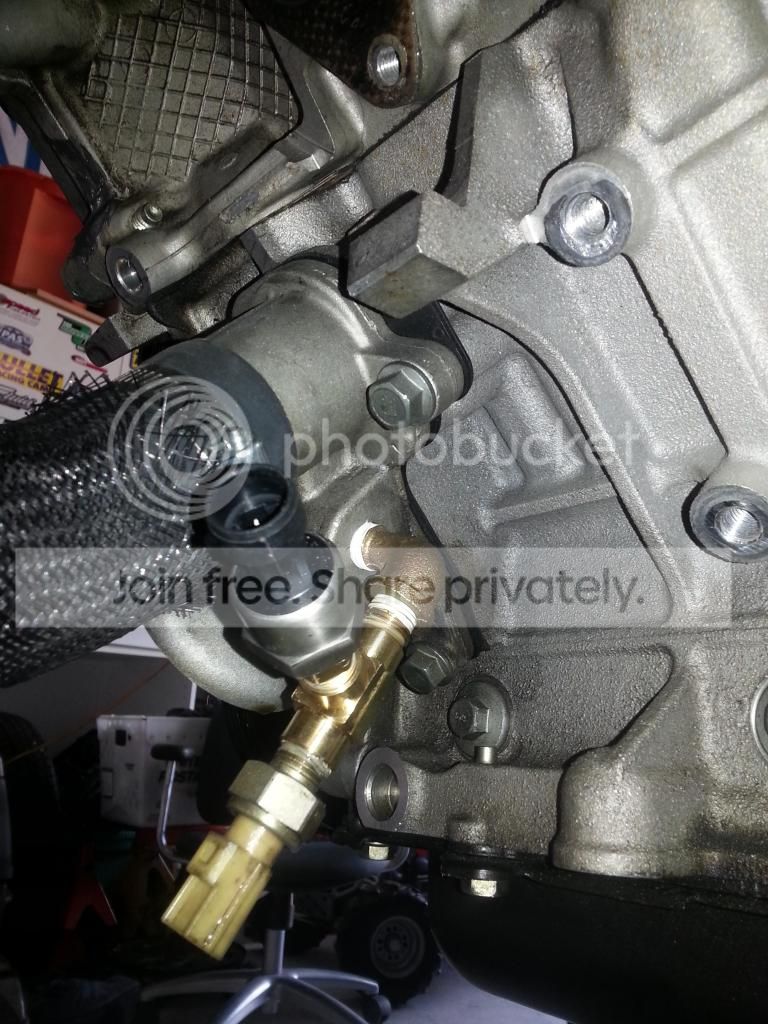

the oil line hook up, how do you have that plumbed? would you mind a picture? I am going to run a oil feed and sensor for the gauge and just ground out my stock oil pressure wire since it's just a dummy gauge anyways.

I have an Aeroforce Interceptor gauge I bought the oil sensor for just before I pulled my motor. Here's a pic of how it's plumbed, is this what you want to see? With this arrangement the OEM gauge still "works"
you the man! yeah just wanted to see how you plumbed it. I don't plan on using the stock sensor. I was debating either to T it off for oil feed and sensor or drill a separate hole and tap it so I could run both with out fittings everywhere lol.
The fittings aren't too bad, you can't really see them since they're down below everything, especially since you'll eventually have your turbo plumbing covering all that area up anyway :beerchug2:
lol this is true, but really what I plan on doing is drilling and tapping another hole right on top of that outlet hole for the sensor just far enough back to clear whatever might be screwed in that main hole. that way I don't have to worry about brass fittings everywhere lol. I have a ton of fittings and I'm not exaggerating but I hate using them when I don't have to haha

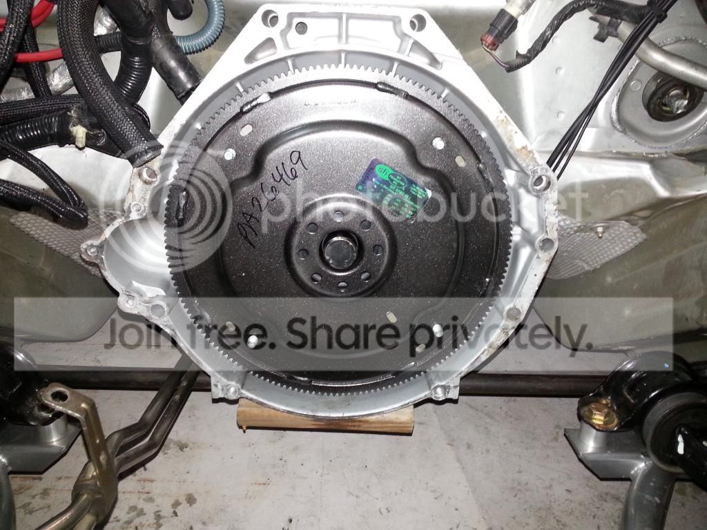

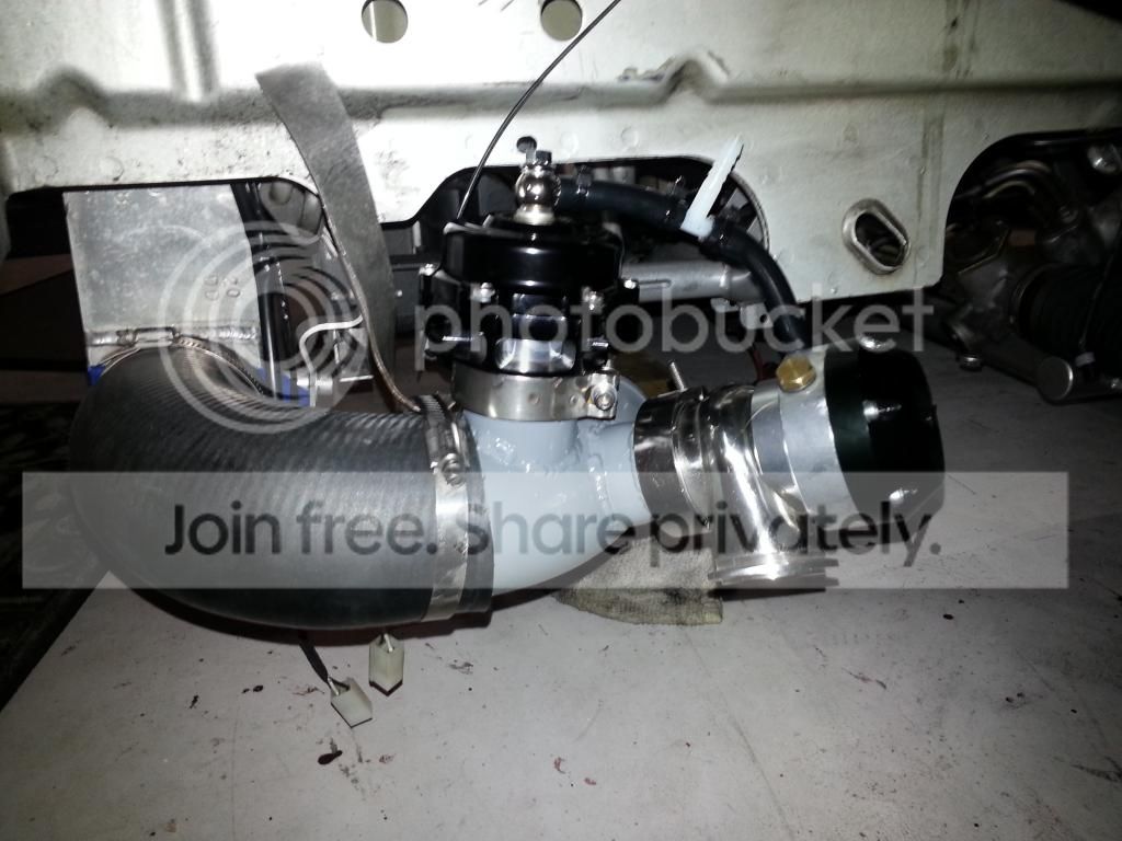

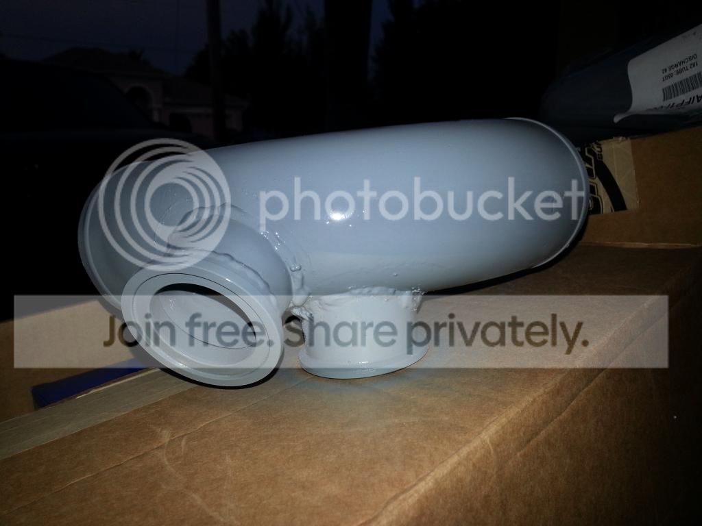

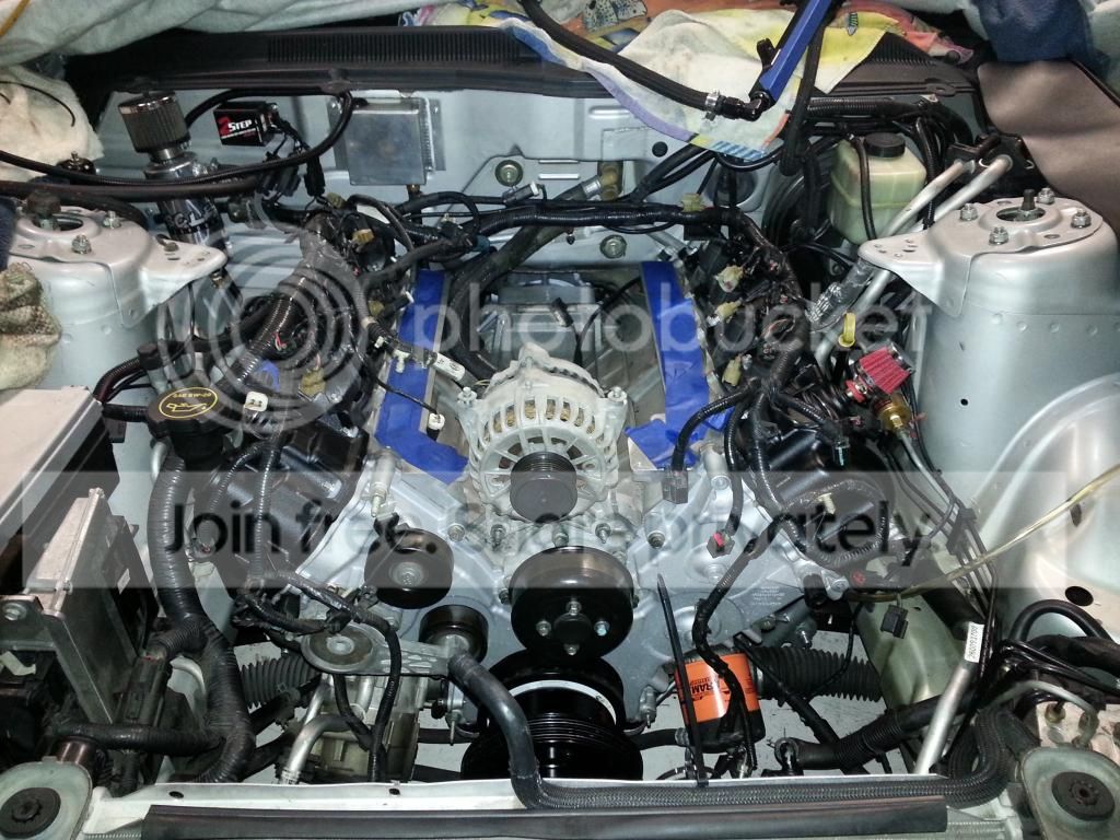

Update: I attempted to drop the motor back into its home last week but ran into a road block with flexplate fitment. I'm embarrassed to say it took a couple hours of messing with it before I threw the BS flag and realized something was very wrong. The stud holes were slightly off so I removed a few thousands to make them fit then realized the flexplate wasn't properly seating on the convertor tabs so I had to call it a night :argh: After a couple days research I found the correct flexplate for my application and of course it costs 6x more, figures. In any case it arrived this afternoon so hopefully I can attempt to at least drop the motor back b/w the frame rails tomorrow night after work, depends if I can get some help, definitely couldn't have done that myself! I made sure it fits this time!

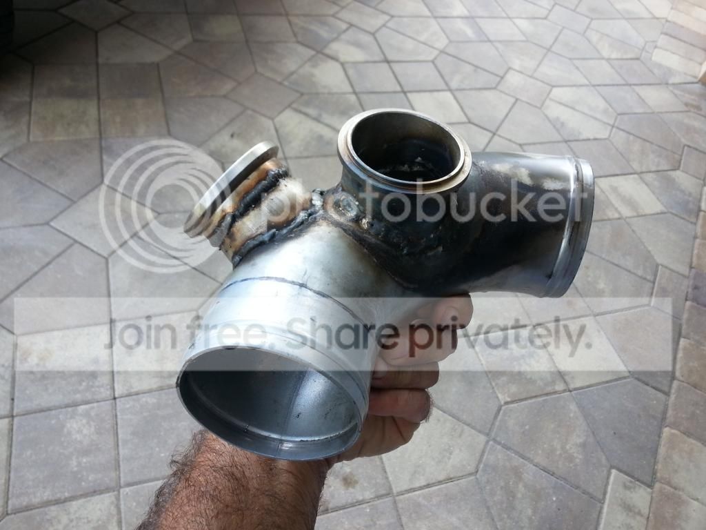

In the meantime I had the new mounting sleeves for my (S&H) BPV & WG welded onto the SC discharge tube before the IC, check out this sexy piece!

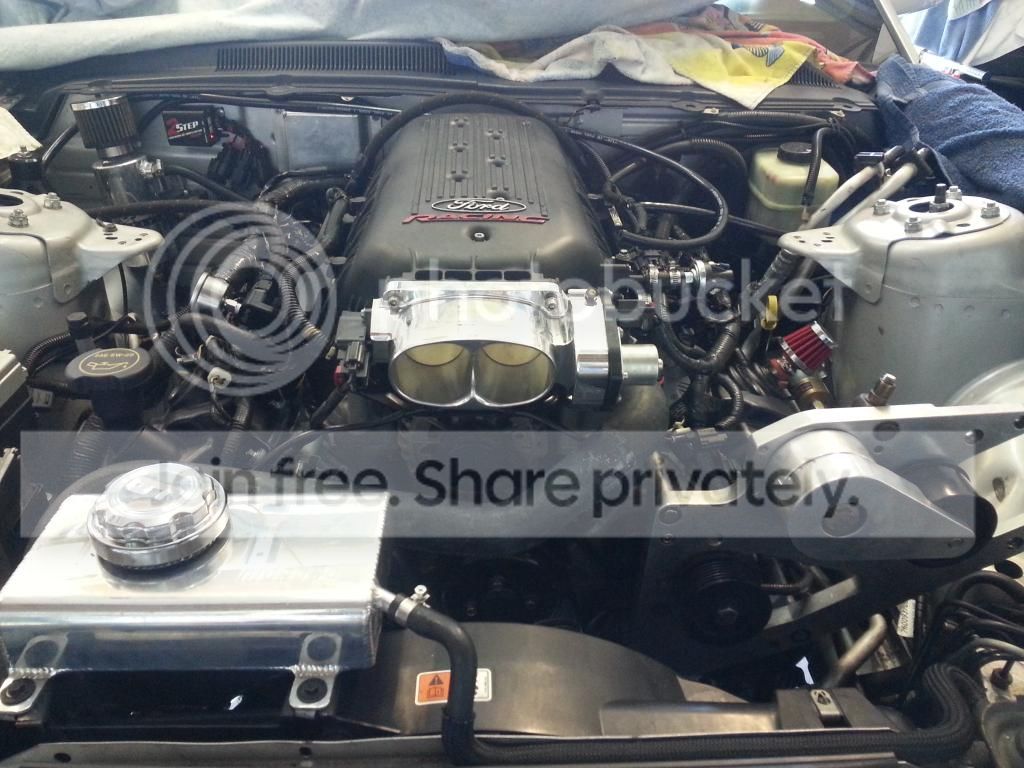

Got to work on it some today, got a lot done but ran into some roadblocks that prevented me from cranking today. Need to extend my new exhaust by 4 inches, this is what happens when trying to use different manufacturers...need some T connectors, vacuum line, etc. Also I need to work on gaining more space up front for the SC plumbing, thanks for the suggestions oneeyedwilly! Procharger wont have my new SC to me until after Labor Day due to necessary parts on backorder argh! Supposedly all F series blowers are on hold until then, Gettin there though!
I was able to flash the ECU with my new base tune from Lito, and fired up the return style fuel system for the first time, pressure was right at 40lbs, no adjustments needed, and even better no leaks!

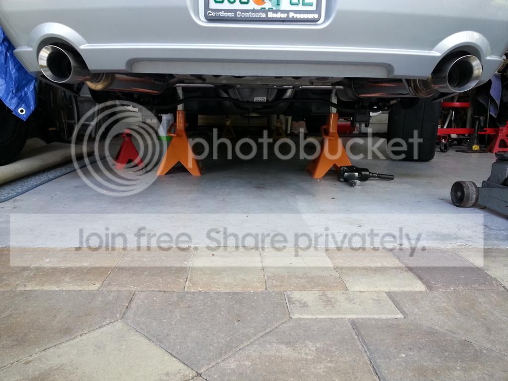

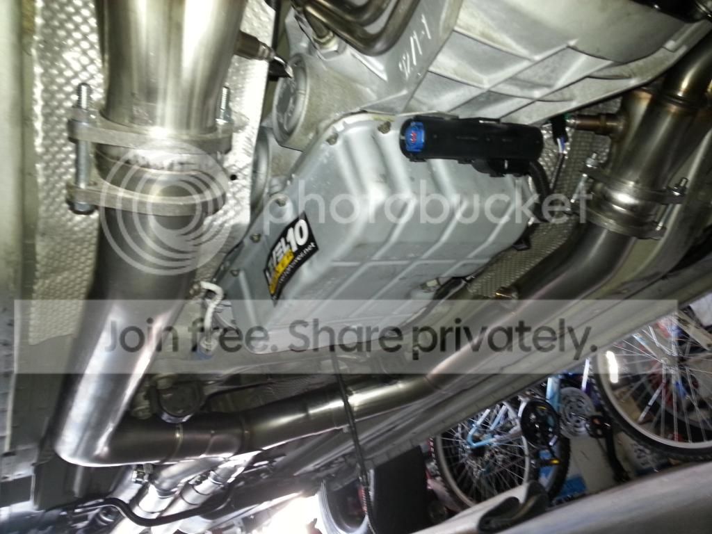

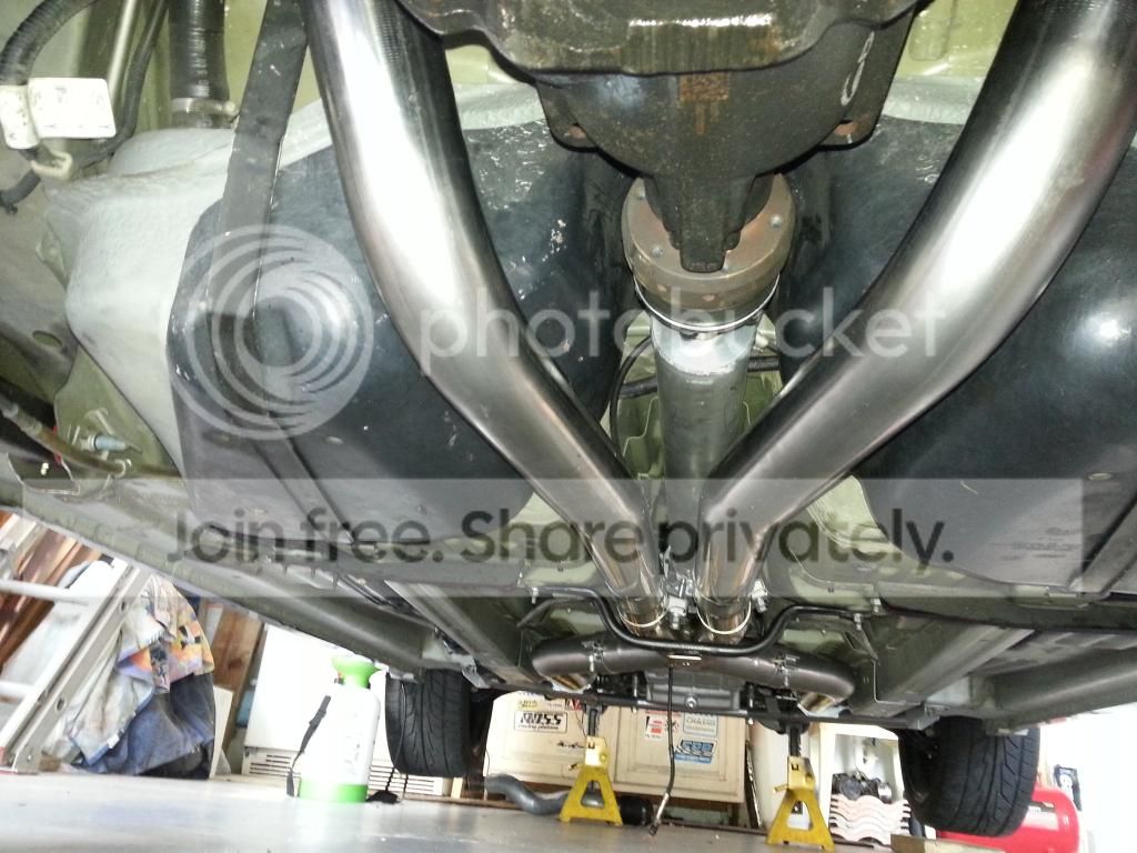

After a couple trips to the exhaust shop for mods to my two systems I was finally able to install the new 3" exhaust. Kooks 1-3/4" headers w/3" collectors and 3" O/R X pipe and Magnaflow 3" cat back & mufflers. Had to extend the cat back by 4" and flare the front of the Magnaflow system to fit, their 3" cat back system only comes pinched down to 2.5" to fit the stock mid-pipe, go figure! Also ordered new upgraded SC pipes from Procharger today, hopefully everything will arrive next week and I can finally crank the new motor!
