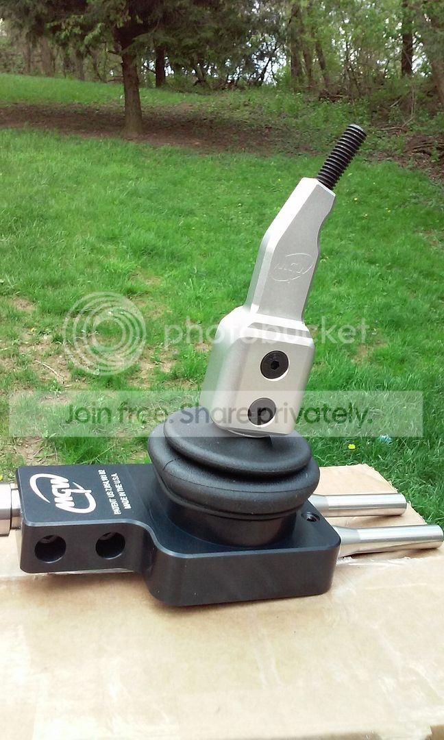

Finally installing today...
The big rubber boot looks like it's going to be a PITA to get over the small rubber boot on the shifter...
10GreyGT
May 14, 2014
44
PA
Just so I am sure...
The bottom of the rubber boot/floor seal goes in this groove?
