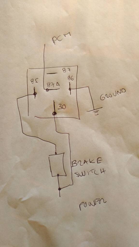

Over a year and still tinkering with it lol. I got the cruise control working tonight. It's not 100% working, but it works.
There are several things the Coyote PCM looks for when engaging the cruise control. There are two switches inside the Coyote brake pedal switch that trigger two PIDs, BOO1 and BOO2. Both must be off for the CC to activate. It also looks for clutch pedal position. For BOO1, I just have pin 13 on the body harness removed from the PCM. This is not particularly safe, since the brake pedal WILL NOT disengage the cruise control. For BOO2, I have pin 39 (3V, white wire, speed control deactivator) pinned into pin 46 on the Coyote PCM. This lets the system see that BOO2 is off when the clutch is up, and on when the clutch is depressed. This also lets me shut the cruise off with the clutch pedal. I am working to find a way to wire this that lets the brake deactivate the system, but I will have to play around with it some more. The only other "problem" I have is that sometimes the security light blinks at me when using the set buttons for the CC.
I don't use the CC frequently, but I do take a few long trips every year. It will be nice to have the CC working again for those. It gets tiring holding the accelerator for 1200+ miles!

Got BOO1 sorted tonight with some help from Manuel. I used a relay to change it from a normally open circuit to a normally closed circuit. The cruise is now deactivated with either the clutch pedal or the brake pedal. Here is a diagram for wiring in the relay:
