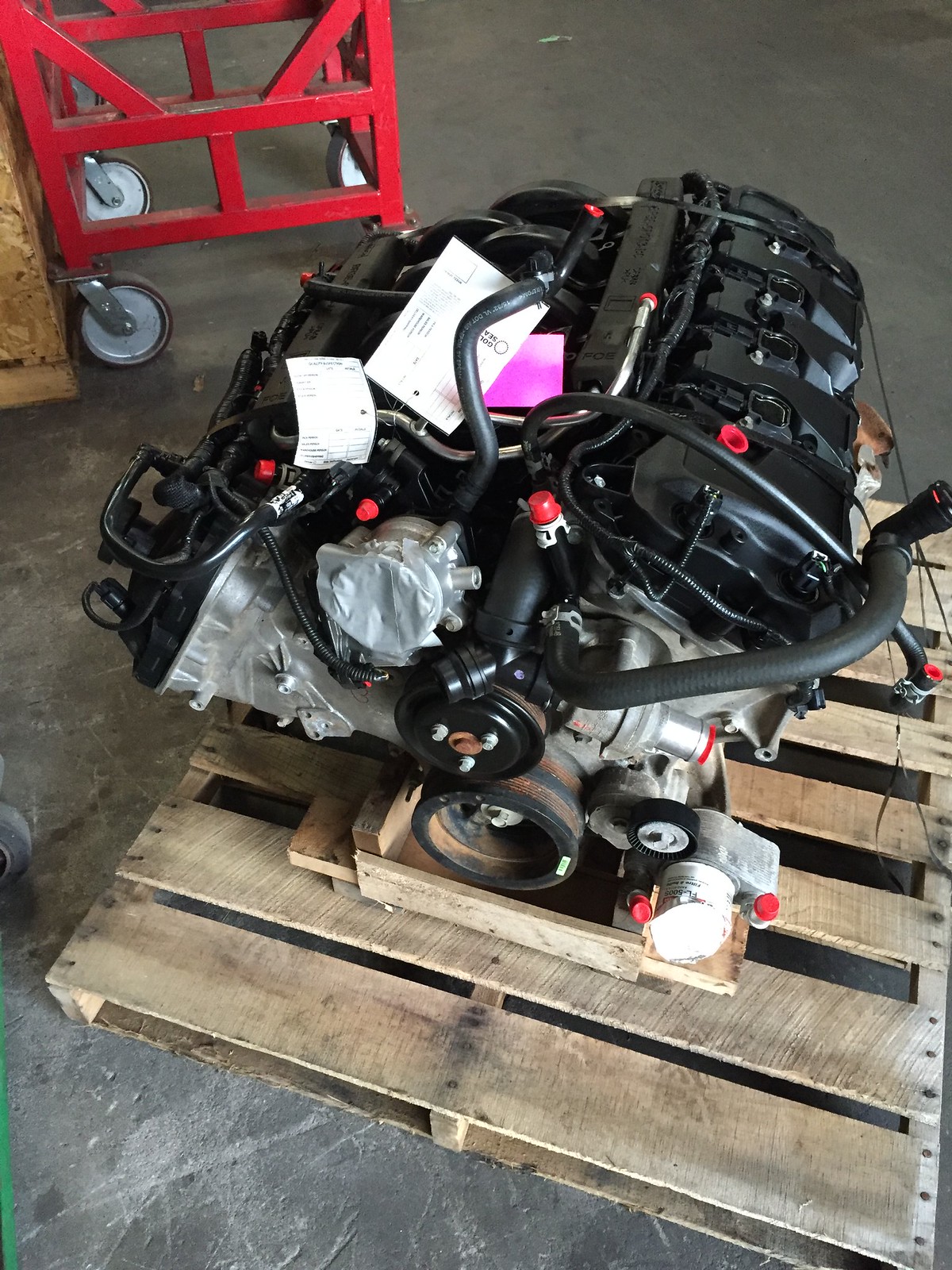

Truck engines are where it's at. I paid $2500 for my engine and you can find them for $2000-4000, depending on the seller. Mine is complete from pan to TB. The differences are pretty minor, intake cam, oil pump, exhaust manifolds, timing cover, and 10.5:1 compression vs. 11:1.
I have the correct exhaust coming, I needed a new TC for the PBH bracket kit anyway, and a few other odds and ends. Oil pumps are under $100 if you're inclined to change it. Stock used cams are cheap. I wasn't willing to spend the extra $2000-3000 minimum for .5 compression. I don't think it will make a big difference. I will also be leaving the truck intake cam for muh torkz and seeing how it does. I'm over 4K right now according to my spread sheet, but not by much. Once I start selling some 3V parts and sell my old engine, I should be into the swap for way under 4K.
I have a blowfish bracket, will review upon install but I am not expecting it to heal my burned up blocker rings. The GT500 clutch master might help ease the load as I'm hoping it makes for a more authoritative clutch disengagement.
Yeah, I'm thinking mine is partially because of the remote design even though I have an MGW and partially because the trans has 155k on it. I figured it was worth a shot. If I don't like it, I can sell it.
Second gear grinds? You should get lessons on how to drive from Kelly. I bet he never grinds or misses a shift. :p
Kelly has been playing with sticks for a lot longer than I have. It's just automatic to him now.
The engine showed up, there was a broken TB plug and VCT solenoid. Disappointing, but used TBs are all over the place and I'm sure I can get a VCT solenoid cheap and fast. I will be contacting the seller to see if they will cover at least the solenoid.

The eagle has landed!

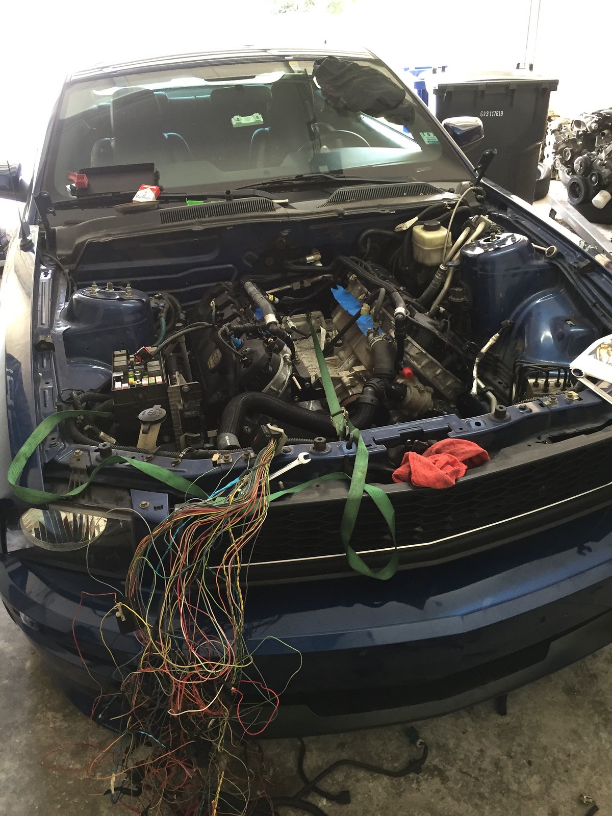

Engine is in and the wiring has started. Major props to my friend for helping me with this undertaking. He is much better with the wiring than I am. That being said, the wiring is more time consuming than complicated. If you have half a brain, I'm sure you can figure it out. Lots of re-pinning and some harness making. The Coyote runs a lot of sensors through the body harness that the 3V runs through the engine harness.
I now see why people do not put together guides for this. It would take so long to actually write it out.
I am annoyed right now at the clips for the coil packs. I had 7 on this engine and now I am down to 3. It appears that 4 just evaporated and I can't find them. Available only through Ford with the purchase of a pigtail.
