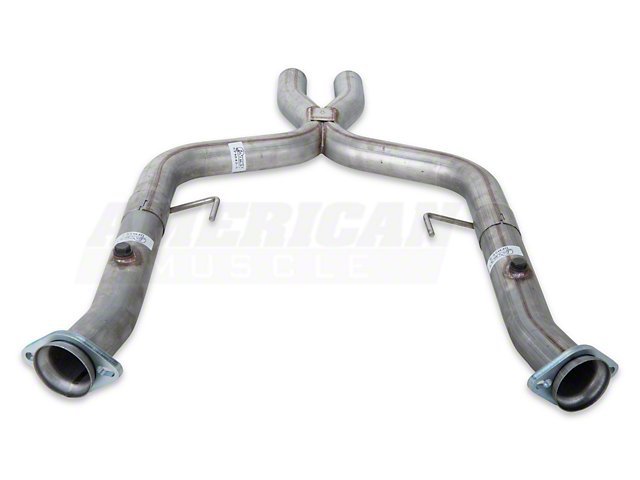

This should work.....but I need to compare costs to having v bands fabbed onto my current x pipe and header vs just buying this......
https://www.americanmuscle.com/pypes-shorty-xpipe-0510gt.html

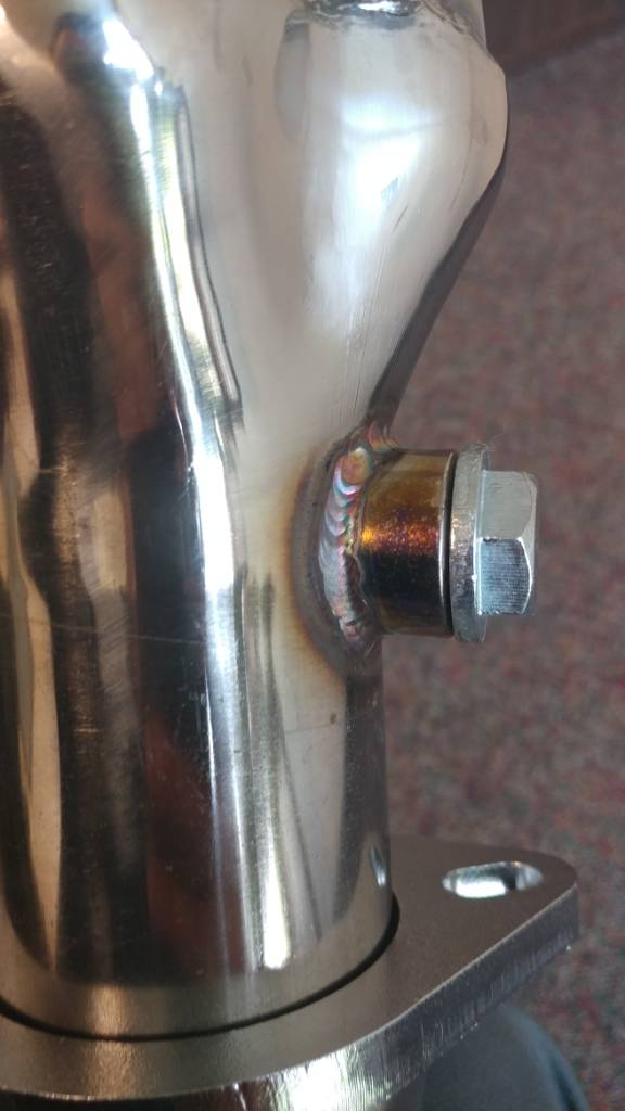

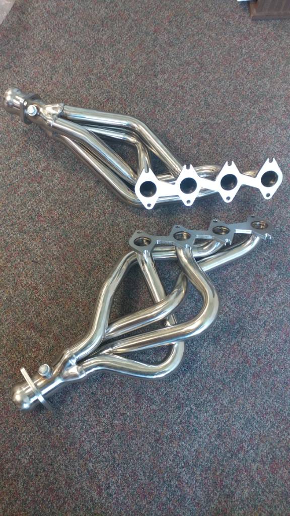

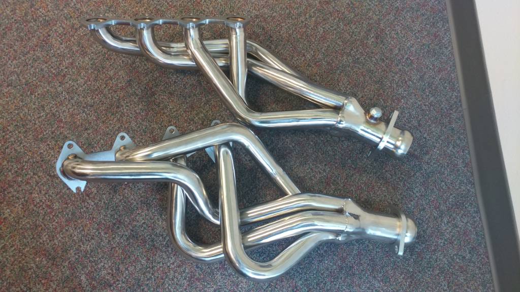

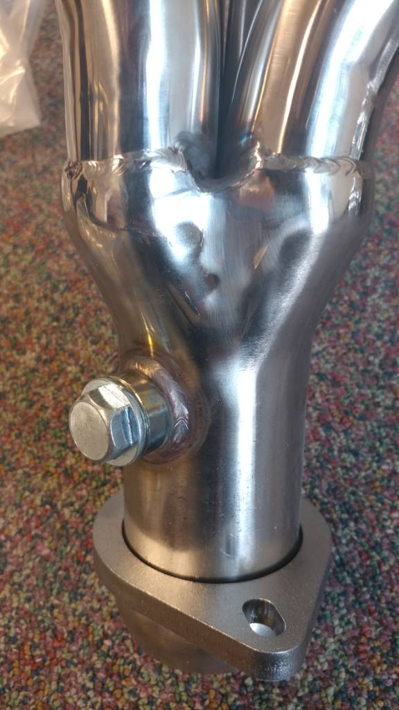

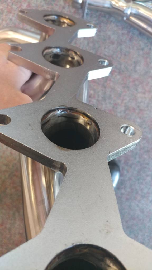

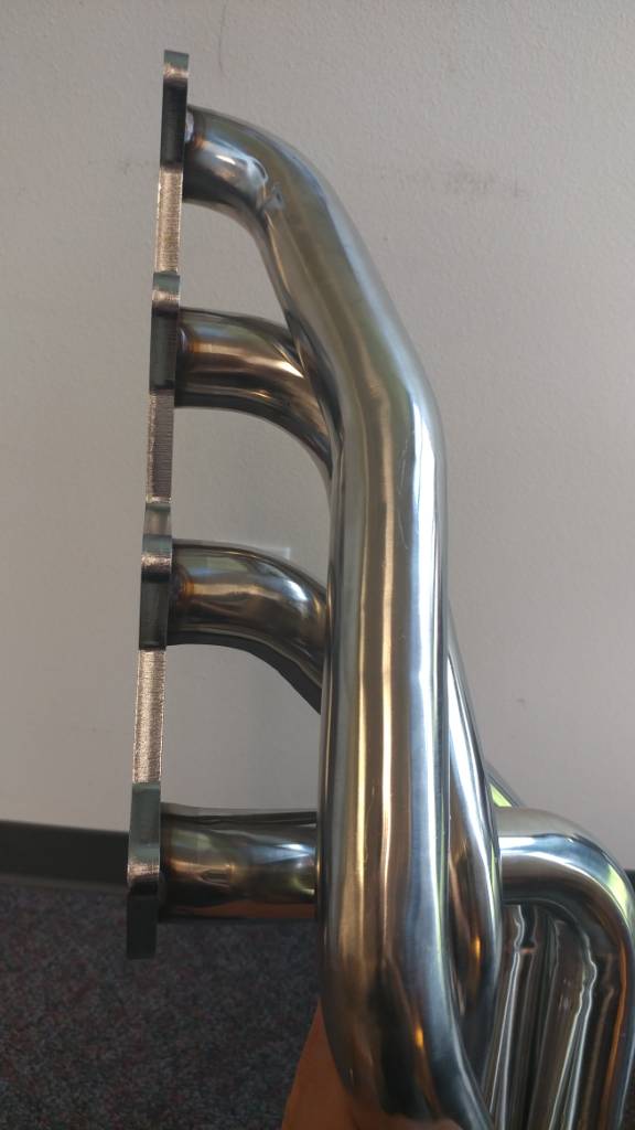

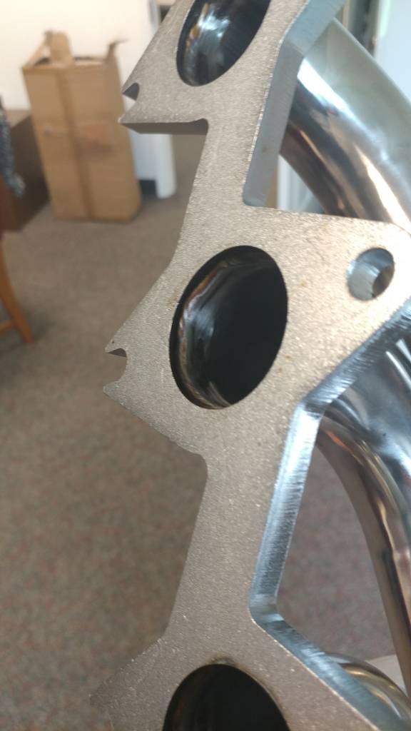

Everything looks very high quality. Welds look good, the man even ground down a bit of the welds in each primary tube (but not too much! Which is great). Overall, whoever built this set knew what they were doing and it was not their first go at at.....probably not their first 1000th go at it. We will see though....we will see. The only thing I can tell that is inferior, is the metal....it shows signs of a slightl lower quality SS.....but maybe that's just how it looks when you do a lot of bending and welding? I am not experienced in those matters.

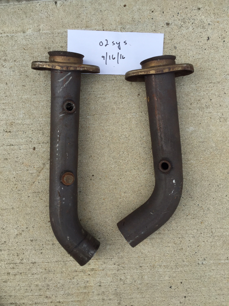

I also have these laying around if anyone wants to fab something:
They are off road legs that were shorten to install some cats but never proceeded. They are meant for stock/shorty headers.
The bend is different for the long tubes:
Thank you. Your pictures gave me the idea to "harvest" my pypes down legs. I bet they fit the socket just fine on my new headers. I will leave the shop to figure out the rest.
