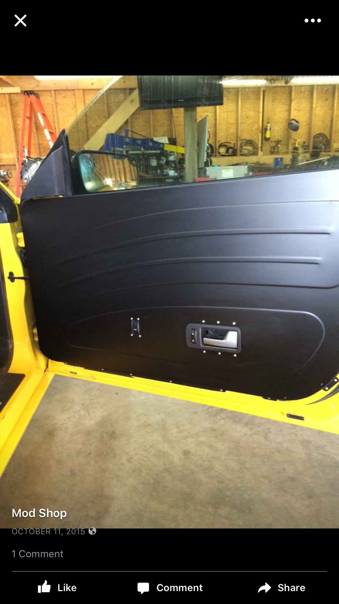

You can just rip off everything sand it down to remove some of the adhesive and buy a can of spray on bedliner from autozone. I did mine about 2 years ago and still looks the same since day one. Here's a pic, a bit dirty from all the handling but you get the idea
I wanted to say I would go your route. I like it the best out of any I have seen. The upholstery shop used some sort of glue that ruined my panels....damn them...not that I couldnt find a another set.....but I am just fed up.
I guess I just want something different. Save some good weight too.

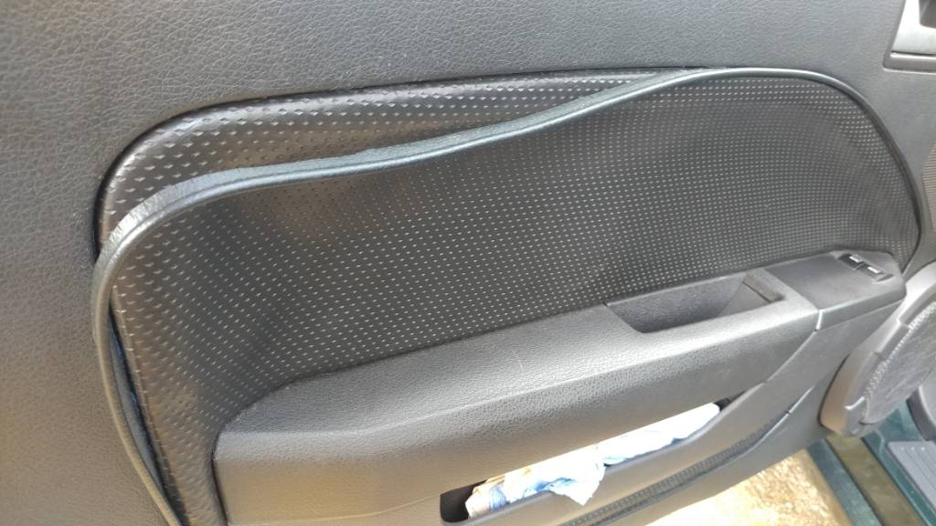

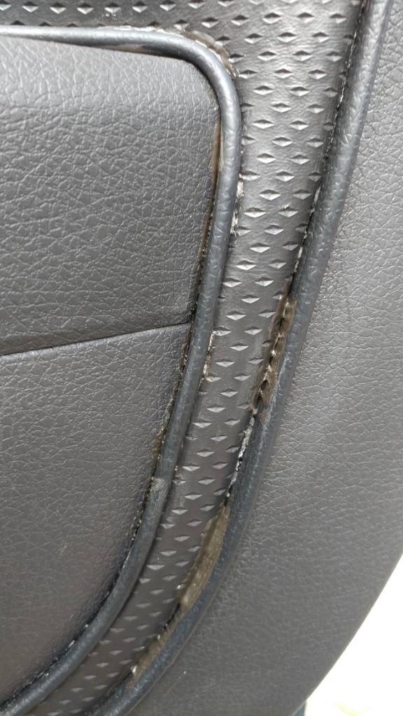

There was someone here with the 2010 panels who had the pleather sag. If they are glued on the same way from the factory as the 05-09 then you'll eventually run into the same problem. The key is in how well the surface is prepped and glued, or you can do what you did and go the Scott Rod route. I'd be interested in seeing how you get the door pull to work.

The vinyl pieces will still fall off the '10+ door panels- they are mounted the same way with that stupid foam, the piece of my passenger side has already come off a couple times.
The big difference is, the '10+ panels are a hell of a lot easier to fix. The piece of vinyl is smaller and there is about 1/4" of it that tucks down in around the insert, and it's not always brushing your arm either. Would be super easy to fix with silicone which is a great permanent solution but difficult to do on the '05-09 panels because the vinyl piece is just so big.

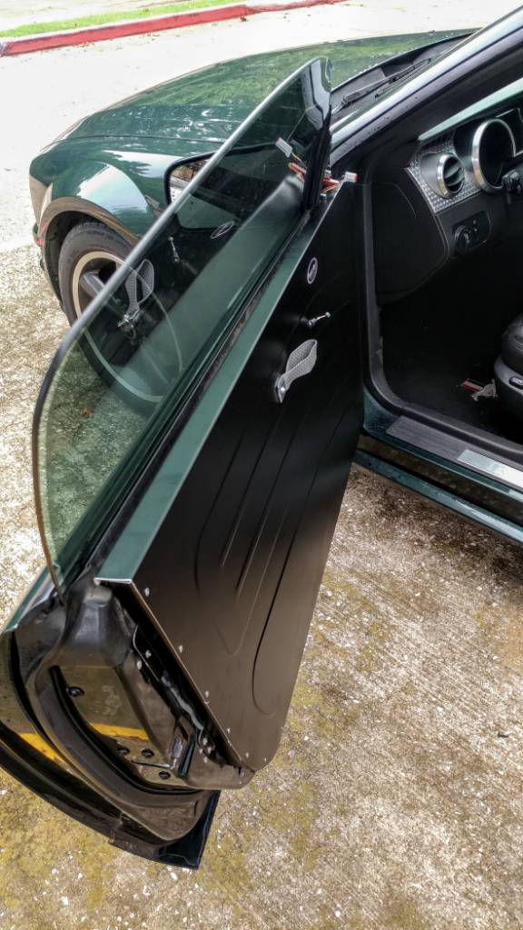

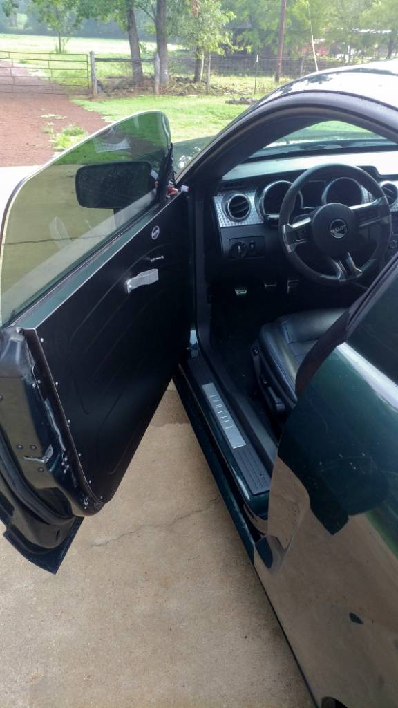

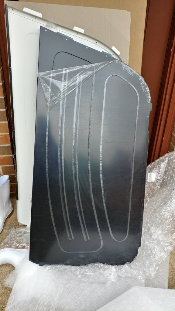

Totally exstatic! The panels came during my lunch break, and after seeing them, I decided to call it an early day and get started. They look INCREDIBLE! First off they were packed very well, with a lot of thought to keeping them safe. Second the paint job ( satin black) is flawless as are the bead rolls. They look so cool in person. As of right now, I am super happy. They even came with quality rivets. Taking the old panels off now and will be mocking them up this afternoon. Deciding how to do the door handles and the door pull placements. The first cut or hole is going to be nerve racking. I am not fully decided on how I want to do the door release. If the stock will fit, then I will use it.

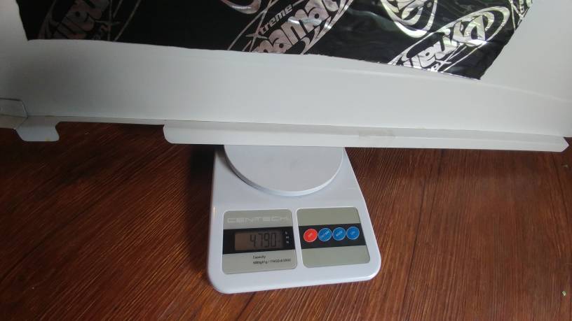

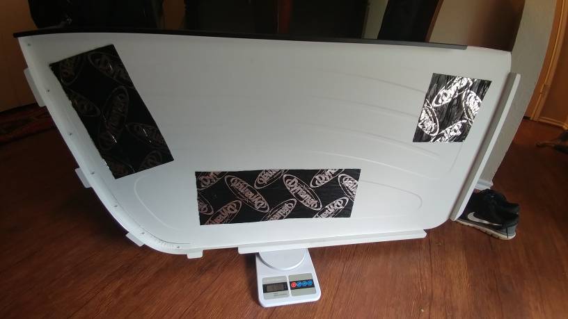

First off. They are much lighter than the stockers. My little scale only goes to 11lbs and with the original it maxed it out with I would guess 2-3lbs left to go.....so say 13lbs each. Then you have the speakers in the doors. Those totaled to 5lbs total. As you can see the Scott Rod panels are 4.8lbs with a little dynamat. So say 10lbs total vs about 31lbs for the original setup. Not a bad way to loose 20lbs. I know it is subjective....but I LOVE these panels.
Also, you want leg room?! Jeeze its crazy, you have so much more space!
I made some annoying mistakes in my excitement. I had to drill 3 rivets out TWICE! First time it was lined up wrong, second time when I closed the door, it sounded like I had left 2 wire coathangers in the door.....super annoying and no way could I just live with it. See the picture of the "body clip nut" ? Not sure what to call that, but it makes a hell of a racket when nothing is bolted to it. Instead of pryingnit out I just threaded the original bolt back it. No big deal.
