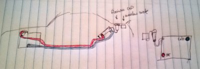

Do I have the hot and cold on the radiator hooked up wrong?

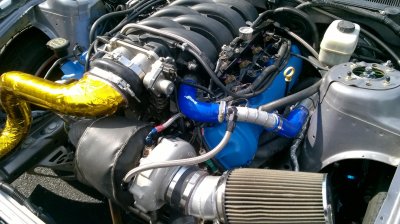

Now that I'm thinking of it, I forgot to include that the turbo is water cooled so perhaps that's not plumbed correctly and causing problems? Is there a flow direction or could the turbo heat be causing it to bubble or get not move water properly?
See attachments for pics and the layout. Thanks for any ideas!

Could it be that the turbo is somehow sucking all the cold water into it and not letting it get into the block at the bottom and then feeding it all into the upper hot tube and right back out.. essentially a bypass? Not sure how all these thermodynamics work exactly :)

The cooling on my turbos run out from the block on the lower-driver side (from the side plug), through the turbos, then back to the exist of the coolant crossover on the way to the radiator on the passenger side of the engine. No overheating issues.

So, should the top of the radiator be connected to the top of the engine where the thermostat is and the bottom of the radiator should go to the bottom of the engine block? Because I think I have mine reversed.
groundpounder
Aug 9, 2011
145
Yes, on the stock setup the bottom radiator to bottom of block and top to top. You get a boost in that cold water sinks to the bottom of the radiator. Are you running a Degas bottle/tank?

I'm not running a degas tank, I have an aftermarket reservoir that has the actual pressurized cap on it which vents to an overflow bottle. I'm going to try switching the lines, I definitely have it backwards as far as top of engine to top of radiator.
groundpounder
Aug 9, 2011
145
Ok, I missed that in the drawing of your system. Where is your air flow coming from prior to the radiator? Is the fan pulling air from under the car? Seems like the air would be very hot after going around the engine/turbo/exhaust before entering the radiator. Is the radiator hot air ducted out of the "trunk"? Seems like the hot air could rise/be sucked back into radiator in a closed loop.
