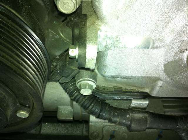

I was not fond of grinding the front housing but I took my time and its not all that bad:

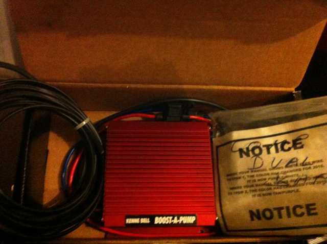

Next install to come is N2MB WOT BOX and dual comp BAP (purchased from a forum member) I do about 95% of all the work on my own car but I'm not the best at electrical soldering so a buddy that's an electrical engineer working woth robotics is helping with the elec. stuff, he also does wiring setups for x275 race camps:

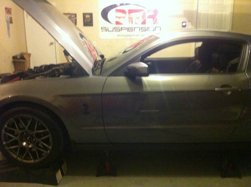

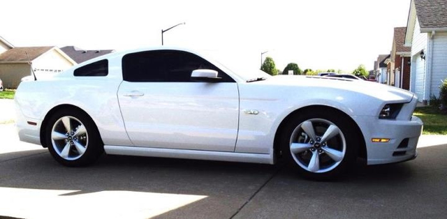

I already had sportline springs because I wasn't interested in tracking the car when I purchased them. With my new plans and with BMR support and help from Kelly and Jason (aka Seer) I went went on a limb and purchased the BMR lowering springs to help transfer weight. BMR does not offer a gt500 spring at this time (what I've been told) due to the spring being harsh and very stiff due to excess weight on the nose. BMR is the best all around for street/strip, as far as I'm concerned, for mustang and I am building it for double duty. After being on the sportlines I admit that the rid was very harsh vs stock. Jason used the GT springs on his car so I bit the bullet and went for it. All I can say is WOW. These things are awesome at transferring weight and ride damn near stock. The progressive rate is awesome and the looks are well you judge for yourself. You will not find a better lowered ride spring that can perform both on and off the track. This thing handles like a dream and has an amazing stance, these are my favorite pics so far.

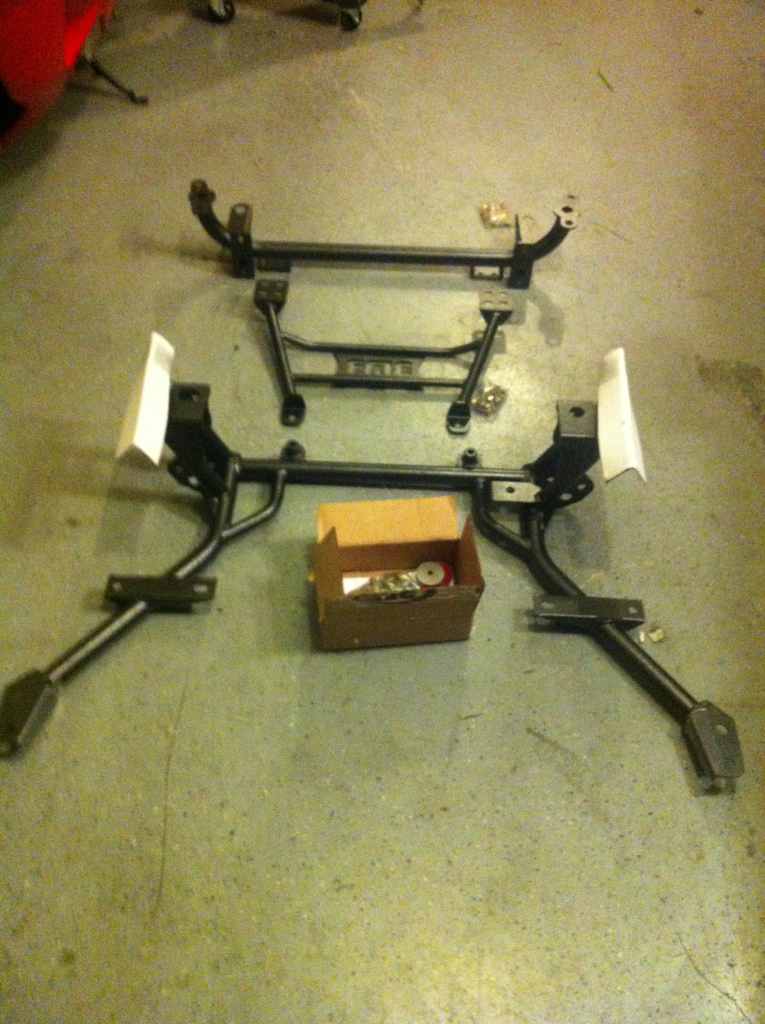

Next was the MGW. There was a 4wk delay with getting this.

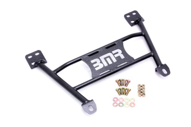

Also ordered the radiator support with sway bar hook up and cassis brace, and soon to come is their k-member
chassis is back order. I'm hoping this pulls some weight off the nose of Of the car:

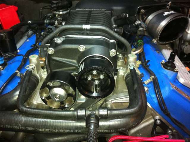

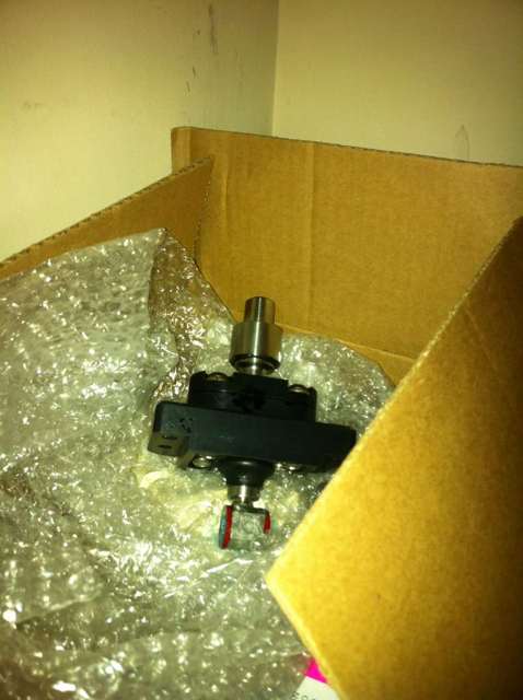

I had been running the whipple 3.0 pulley and seeing about 14-15 psi after adding the 15% lower I installed the 3.25 upper for the street (especially till after the tune). The car will be going to Lee Blankenship's on May 30th for tuning the street tune on 93* and the 3.25 pulley and a race tune on the 3.0 pulley and shell urt. I also had the Metco idler laying around from when I had the 2.6 pulley on the stock SC. I was curious to see if it would work with the 15% to add belt wrap. Sure enough it did and this adds a lot of belt wrap on the SC pulley. For those of you interested in doing this it is a combination of the 15% (I'm sure the 10% will wot as well) the thump RRR tensioner (the pulley from thump is a 60mm vs stock 93mm) the gates geen extended belt and the Metco idler. The idler is in the farthest adjustment slot so if I want to get crazy after upgrading the internals and add smaller pulleys I have room to go down 2 more notches and maintain the tension and prevent any belt slip.

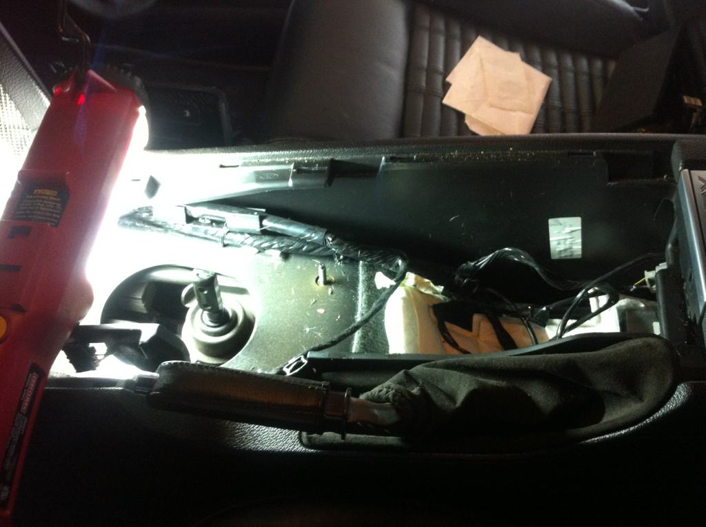

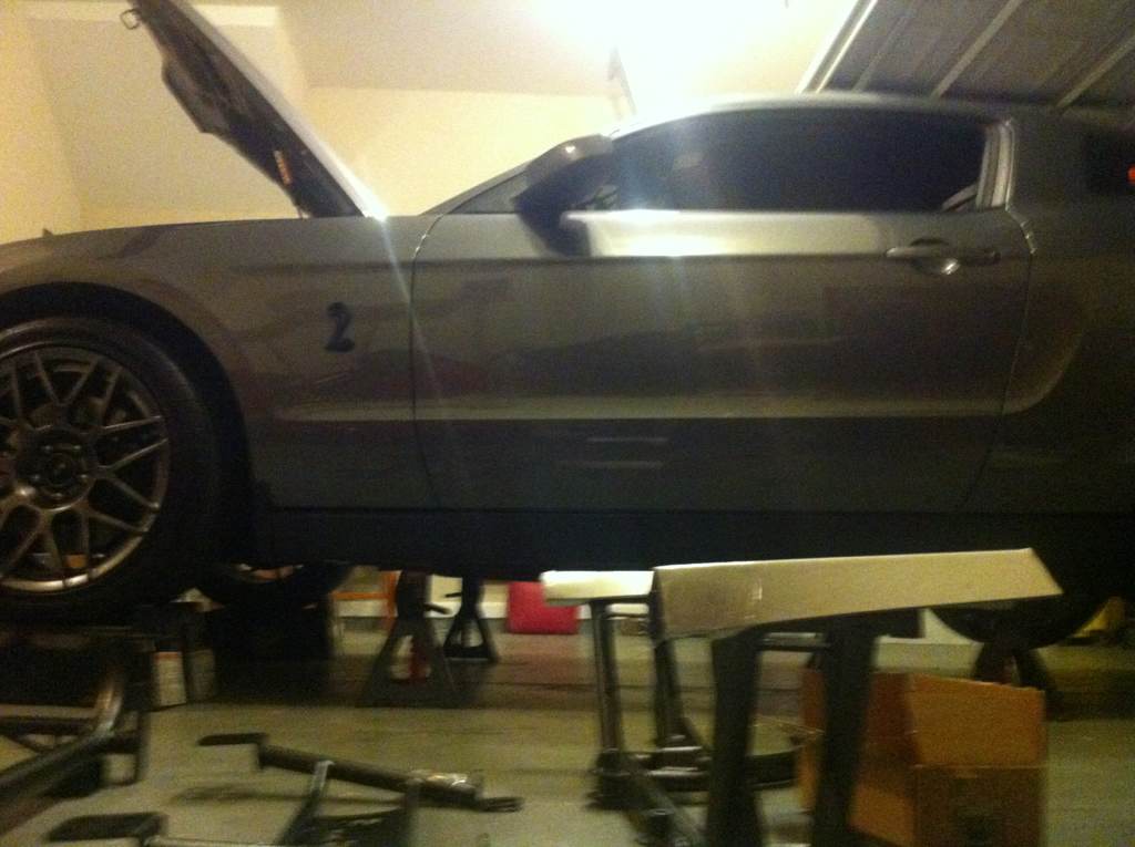

After the SC failure, I'm finally getting to this stuff today.
MGW install....
All of this....
Going on this...
Lets do work...
