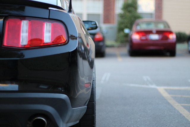

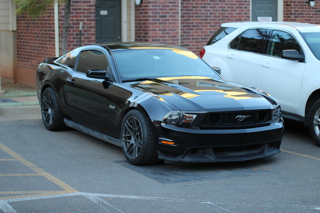

So if you follow my build thread you've seen this, but here is some preliminary info on this setup:
Some of you probably saw this picture:
Well...that was enough. I ordered some 295/35/18 Rivals about 15 minutes later. I have been told the rivals are running big, and the 315/30/18's are very short, so that's why it was 295. I had them mounted and balanced yesterday, and have been out seeing what I can do about scrubbing off the mold release. I have a loop of about 10 miles that takes me up and down 20 on and off ramps, with some increasing radius, decreasing radius, constant radius, straights, decent braking zones, and a couple nice straights. It's not too common to get stuck behind slow people, so it's a nice loop to use to test changes to the car.
Fitment note- with AST 4150 struts and the 18x11 F14, there is an eency tiny rub. Just enough to take a square millimeter of paint off the AST logo on the strut. I'm running a 5/16" spacer, but will look far a smaller one. I think 2 or 3mm would do it.

What offsets are you running? 5/16 spacer is just under 8mm, so I would guess 40-45?

I've seen other Mustangs down here with the 295's on 10's and the 275's on 10's...and they'll both go on there just fine. Give it a shot? The 275 on a 10 does look better, IMO. I was told the Rivals run wide, and I agree with that opinion after seeing all of these tire/wheel size combos.

Ah. I couldn't see the ends too well on my phone. They look flat. What length? Were the studs on before you slapped this setup together? Would you say the stockers would be too short?
Yeah my passenger side wheel hub started making noise so I replaced them with the Ford Racing wheel hubs. The ARP studs are 3". I would not want to run a spacer with the stock studs. I think the need for the spacer is rather tire-dependent, the Rivals have a huge amount of overhang over the edge of the rim, at least half an inch. A "normal" tire probably wouldn't need them.
