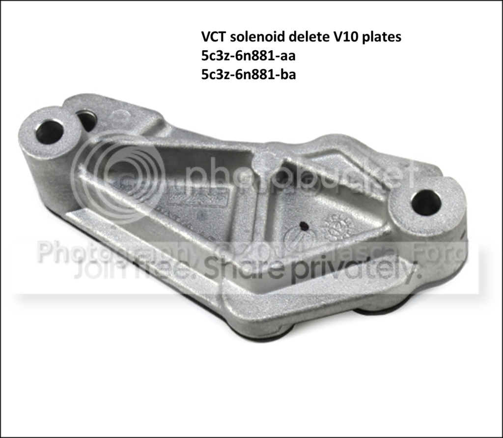

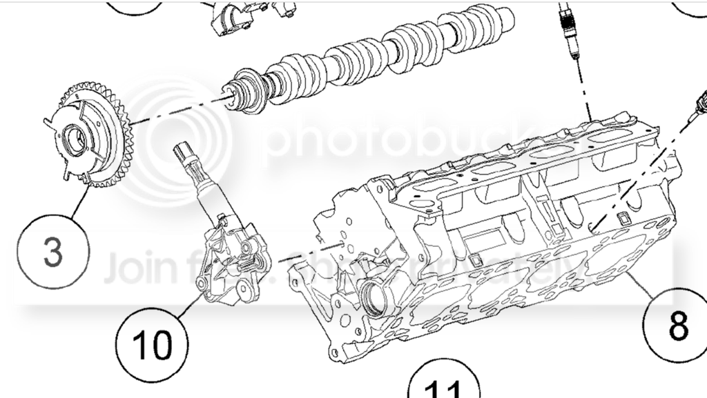

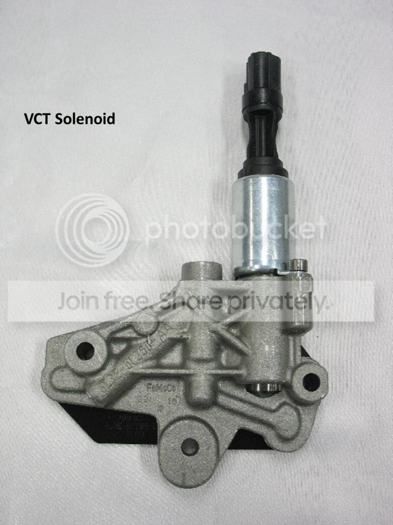

Since I have never taken a head apart and reassembled, I sometimes struggle to visualize what is going on. Since I want to understand every aspect of anything done to my car I work at that understanding. These pictures are for guys in the same boat trying to visualize what is going on with a VCT solenoid delete.
