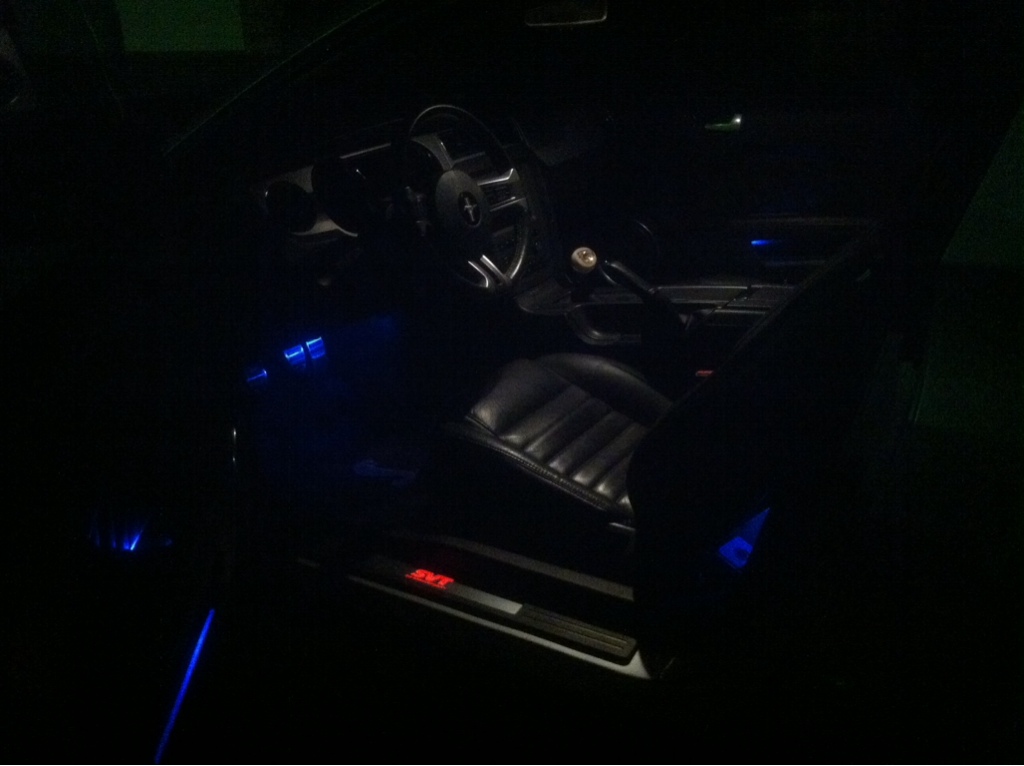

How well do the door panels fit at the rear top of the door? The '10-up doors have a slight curve right there.

Door panels fit good I had to cut them in a couple places underneath though to get them in place and it has a small gap at the top but no one ever notices it :)

Also were the door panels necessary or was it to complete the transformation. Thanks
mustang_cobra
Jul 10, 2013
35

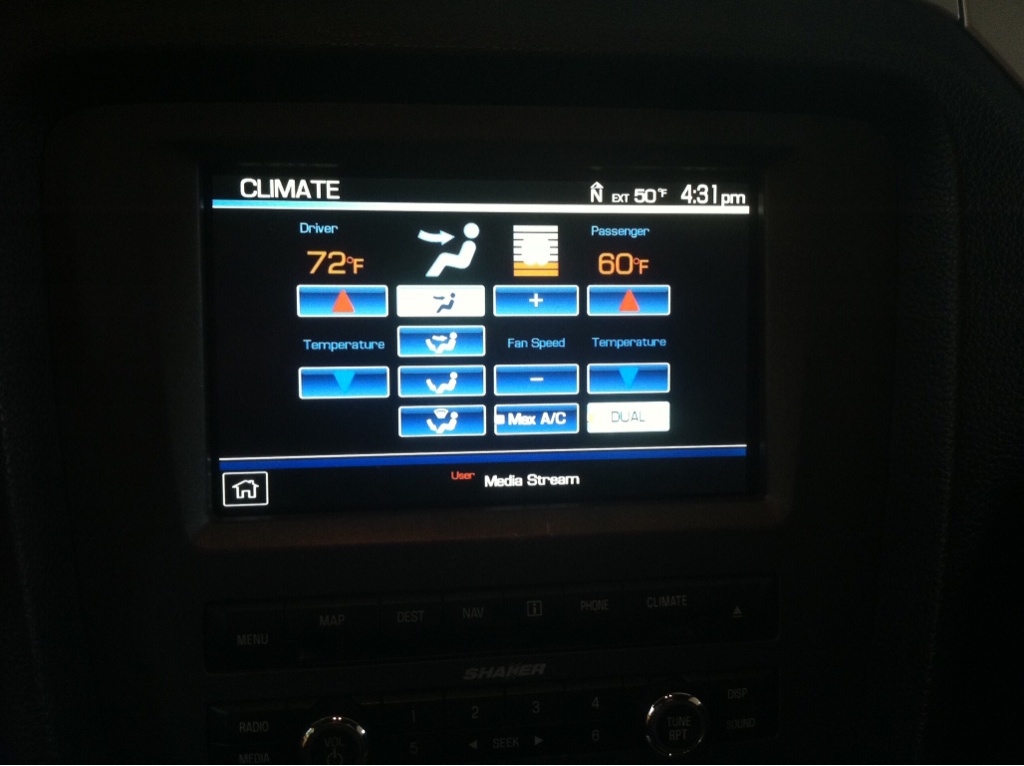

Door panels were necessary to mate with the 2010 harness as they have different window switches..., as far as the dash it was easy bolt in place but the dual climate controll requires the 2010-14 ac box behind the dash so you'll have to notch the firewall some around the hoses
