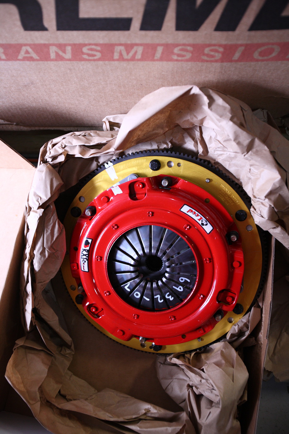

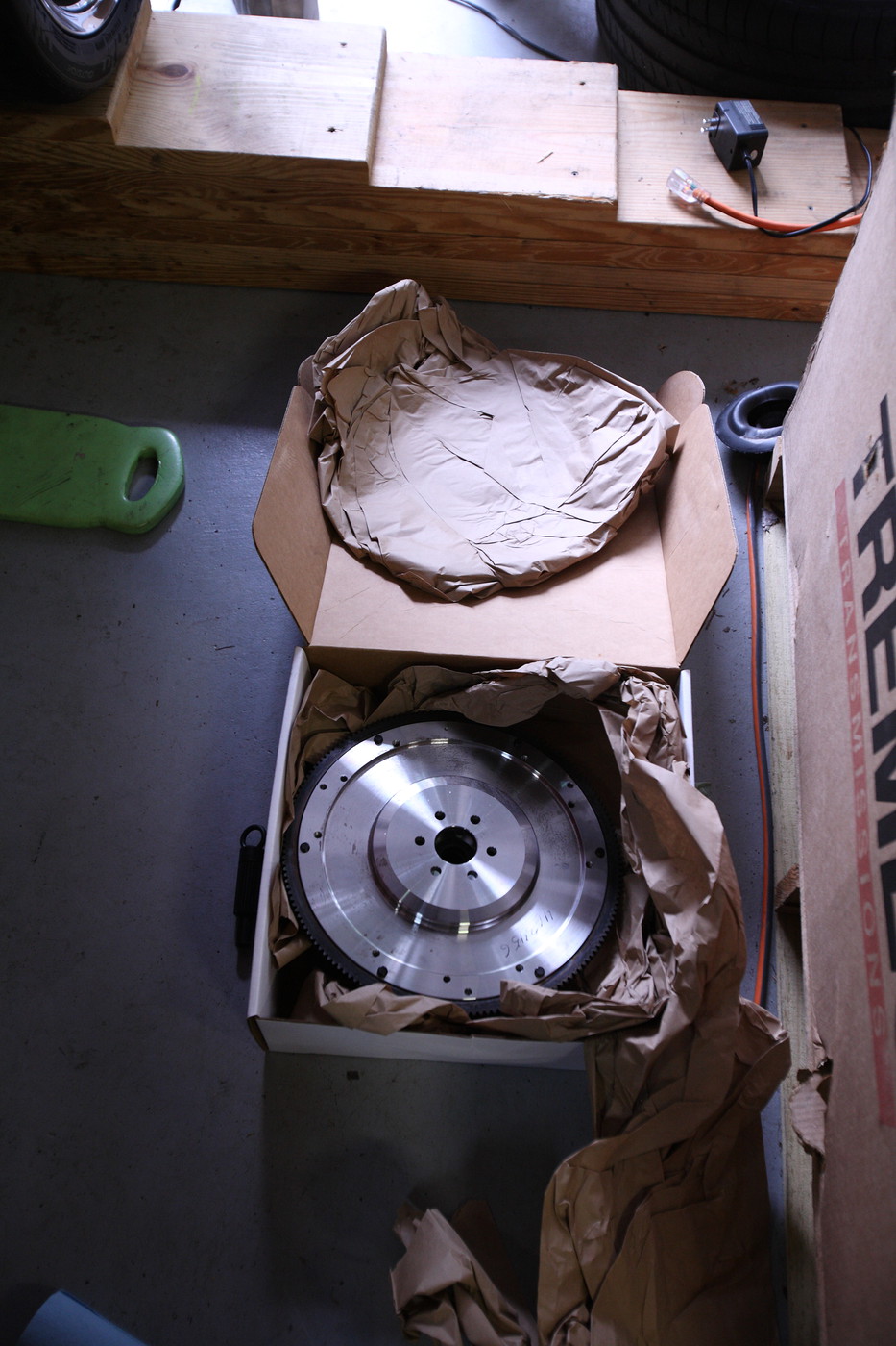

So...Skwerl recently totaled his Bullitt. He and I made a deal on his low-mileage T56 Magnum XL.
I sent his old RST that came with the transmission off to McLeod to have it converted to an RXT. I also bought a McLeod lightened steel flywheel.

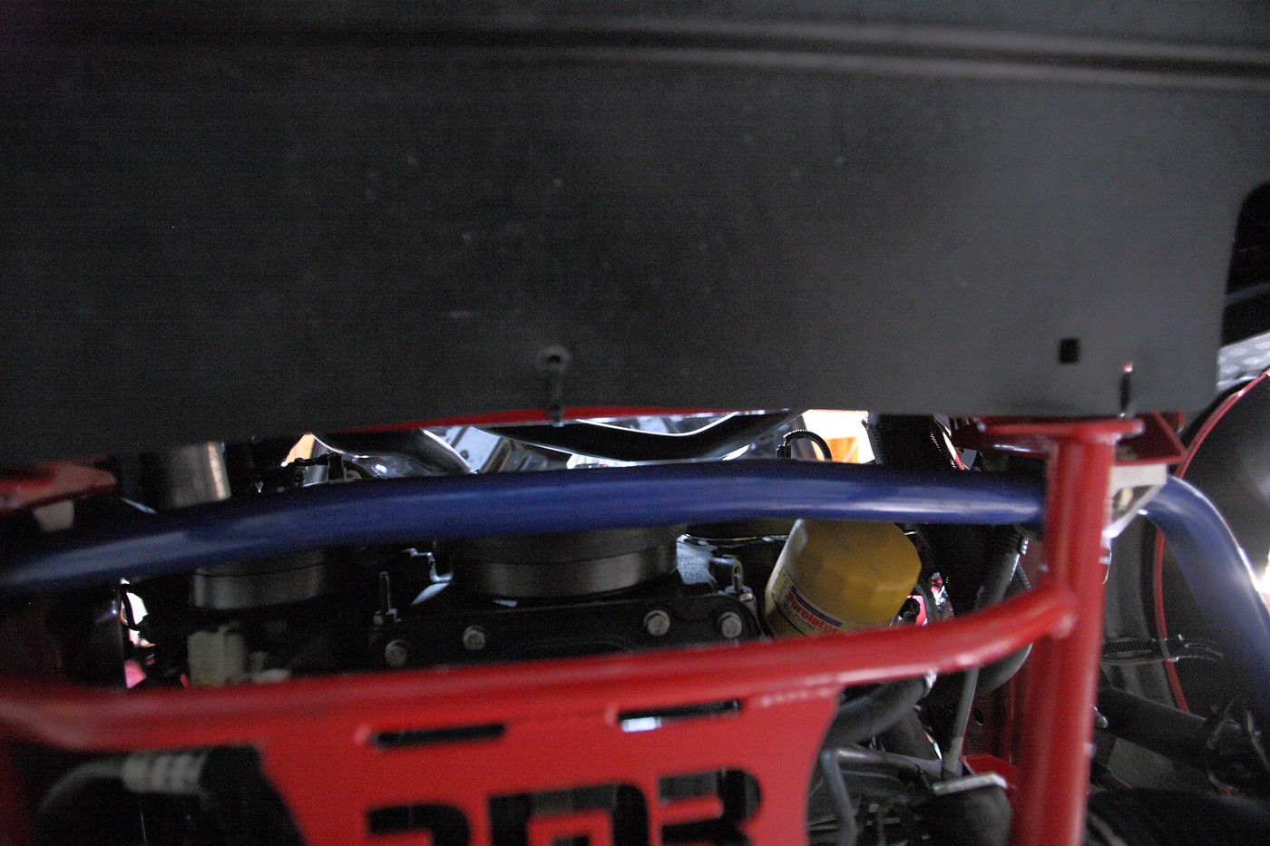

To facilitate removal of the old tranny, I ditched the factory K-member, radiator support, and added all new BMR pieces plus a BMR X-Brace:
BMR KM011 K member (1/2" lower motor mounts)
BMR RS003 radiator mount with sway bar mounts
BMR CB004 Chassis brace and radiator support
The RS003 rad mount had terrible, terrible fit. Rad mount location holes were too narrow vs the OEM mounts points and the sway bar mount holes also did not align. I had to take a hydraulic RAM spreader to it to widen out the rad mounts a bit and then beat it straight to my liking with a giant rubber mallet, and then I had to grind bigger holes for the sway bar mounts. Almost boxed it up and sent it back, but you know me...I made it work. I'm your ModFather. My sway bar mounts are Steeda billet mounts, so that was part of the issue, but the Steeda billets are plug-and-play with the OEM mount holes, so the BMR mount holes should be identical IMHO.
Kelly gave me feedback on another forum. I guess the factory sway bar mount holes vary from year-to-year, so BMR can't really make holes that fit other aftermarket parts.
On the topic of alignment and tolerances: I know tubing flexes a bit when it comes out of the jig, but there is no excuse for holes not aligning closely within factory ranges and having factory-width tolerances for the rad support bushing grommets. How many guys have hydraulic spreaders lying around? More BMR feedback: They are correcting the distance for the radiator mount spacing. It was off on the factory jig.
The K member was fine, save for the A-arm mounts being very, very tight. Again, these should be checked for tolerance before shipping.
And...generally speaking...the BMR directions suck. Guys like me are perfectionists, so I want to know what washers go where, which direction to insert bolts, lots of pics, etc.
Bear in mind that 1/2" lowered motor mounts on your K-member like I bought may cause long-tube header clearance issues with your steering shaft. I'm still battling that one. I had to "clearance" my headers a bit with a BF Hammer and a big punch, and I may have to ground my steering shaft pinch bolt head down a bit...both on total bolt height as well as the diameter of the round flange.
With all that said, I do like the BMR stuff overall and I would use it again. BMR are true innovators unlike other copy-cat companies.

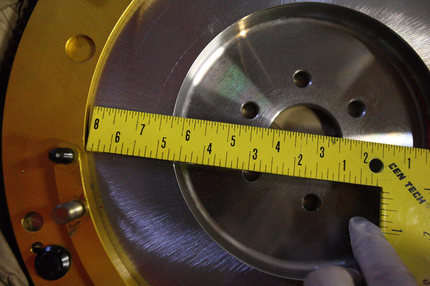

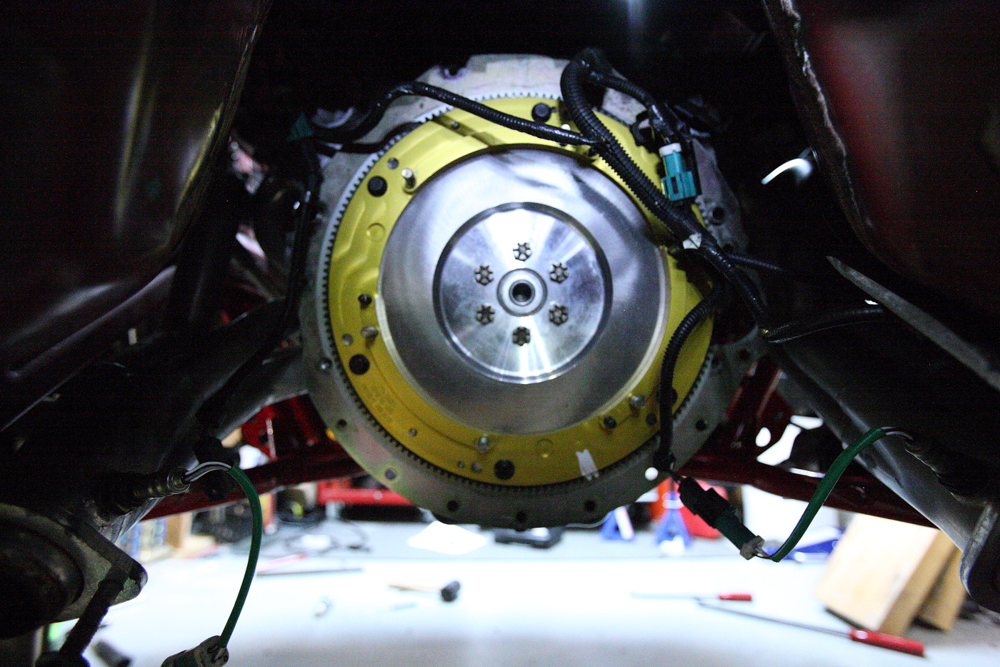

Then the McLeod lightened steel flywheel with adapter ring (factory installed ring by McLeod). I added a new pilot bearing as well. I used a Harbor Freight pilot bearing puller tool, but I had to grind down the flanges as the diameter was a little too big (not shown).

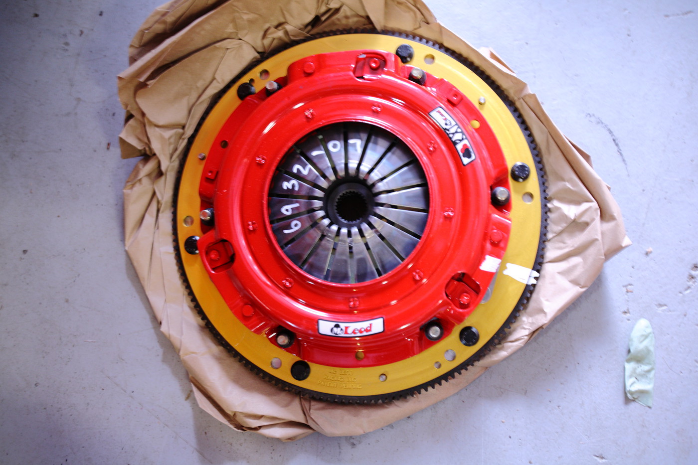

Then the first clutch disc and floater ring:
Then the outer disc and the pressure plate:
Then I marked up the scattershield and mated all bolts:
Then I installed it, followed by the starter:

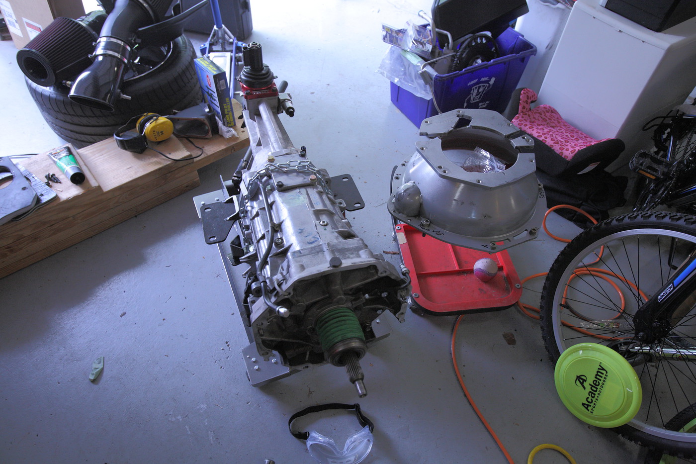

I added a new slave cylinder, then stuffed this baby in there using a Harbor freight low-profile tranny jack:

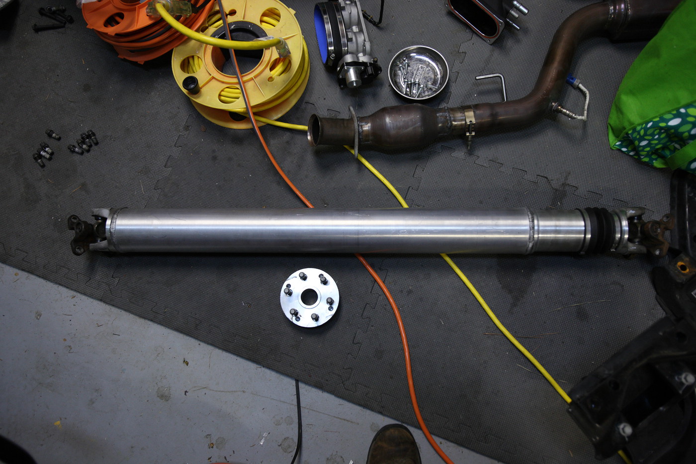

New DSS driveshaft with slip-yoke that mates to the T56 Magnum XL:
JPC driveshaft safety loop also added:
