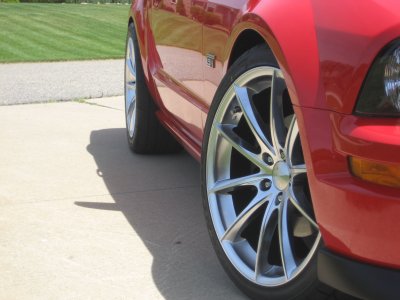

here is what it looks like now with no name 275's on the back. I think the cheaper tire makes it look stretched on the rim.

Yes the will fit, make sure you have the right offset on the wheel of they will rub the fender. My +35 rubbed barely, I would thing anything with a +40 ish or higher should work.
