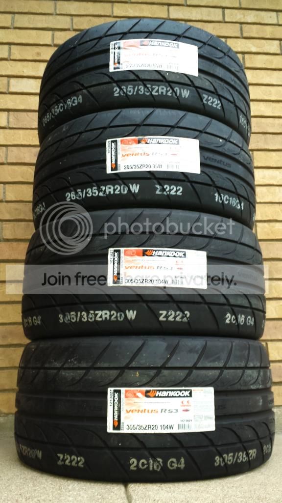

Just FYI,
I ordered a set of Hankook Ventus R-S3s from tirerack.com in the same sizes I was already running on the car (265/35 and 305/35). The only change - or so I thought - was moving from Nitto NT555s to Hankooks.
But when I laid them next to each other, each of my new tires was an inch wider than the ones being replaced. I was nervous - and pissed!
Fortunately they all fit fine. The S197 can take a pretty big tire.

Just FYI,

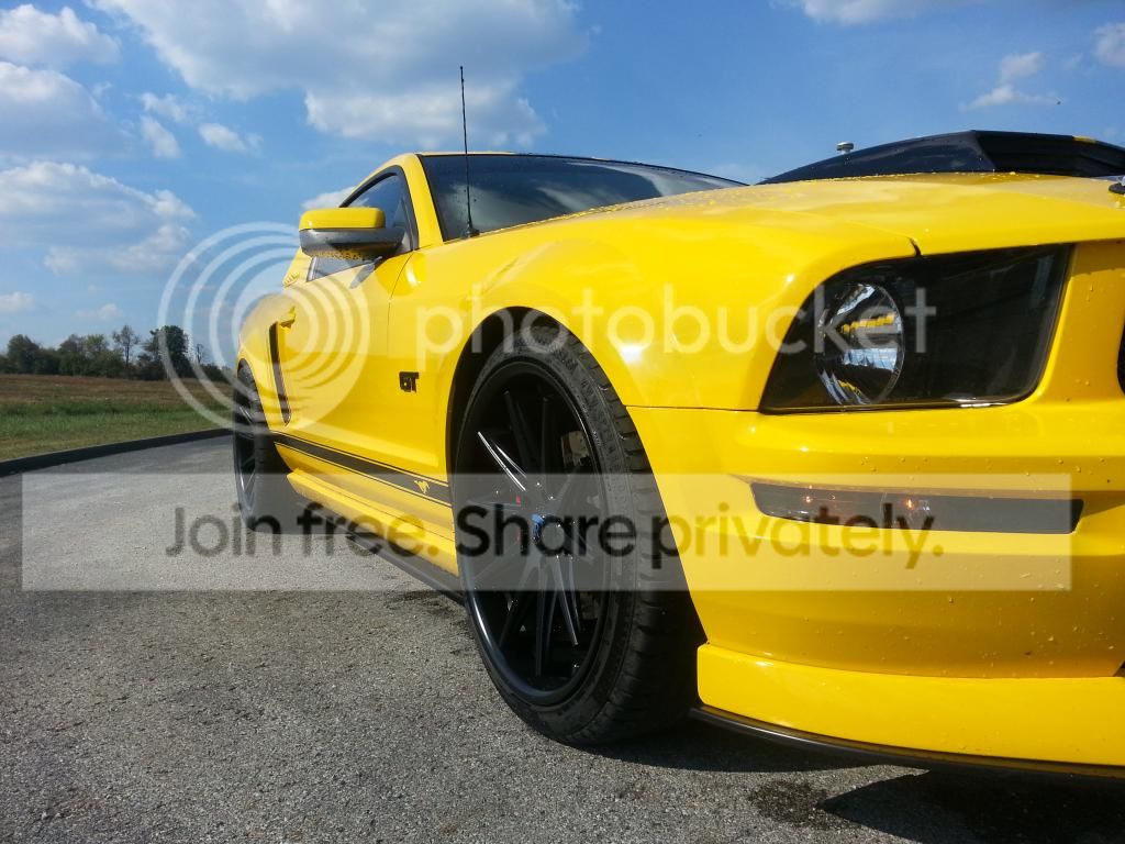

I was thinking hard about the yellow letters from that website they posted, i just wanted to make sure*i get the tires on then ill photoshop it again and decide.

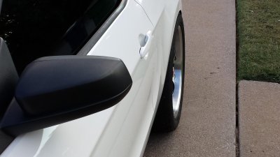

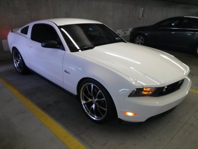

I know they're not the MTs that this thread is about, but I suspect my Hankooks are close in size. I just wanted to show how a 305/35-20 fits on a 20x10 +45 wheel. It's right on the fender edge but doesn't seem to be rubbing. Might be too big for some but this is how a set of wheels and tires are supposed to fit IMO.
