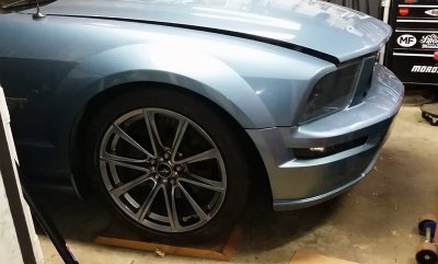

I want to see these wheels on aS197....
image.php
I know this thread is just a little old, but see attached image.
In the middle of a brembo swap and haven't had a lot of time to work on the car, but when it's done I plan to take more/better pictures.

Will add this in just so people can see them.
0 fitment issues, you need your current lugs and TPMS. Non Brembo car.
