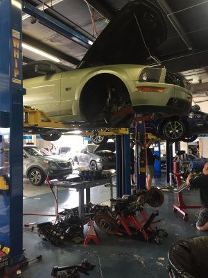

I'm UP!!! And so is the car.

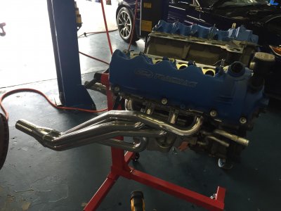

Here's the assembled motor minus the C&L Al intake.
I am so ready to begin the break in process. I wish I hadn't just typed the word "break" in this thread. I've seen too many 'good build gone bad' threads on this forum to be comfortable. Even when all the work has been done by pros with tons of Mustang experience.

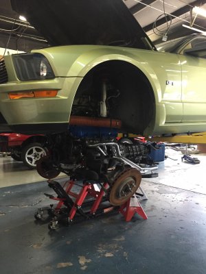

Preparing for the marriage.
I did manage to get my '02 VW GTI "parts car" out of the designated Mustang spot in the garage last night. I may try to bring the GTI back to life if the problems under the hood don't prove to be cost prohibitive.

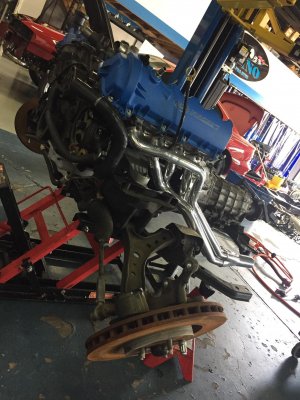

Mawage. Mawage is wot bwings us togeder tooday. Mawage, that bwessed awangment, that dweam wifin a dweam...

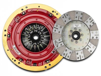

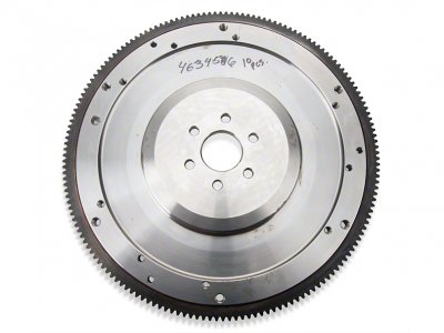

Out comes the Ram Twin Disc in favor of a McLeod RXT, McLeod lightened steel flywheel, and FRPP SS clutch line. If I do add turbos, I'll need the extra capacity of the RXT, so may as well do it now.
I have an estimate from RAM of $550 to rebuild the existing clutch, so we'll see how long it sits on the shelf or I test the open market.

That looks like a good choice. I have the RST waiting to go in with the T56 XL when I get time.

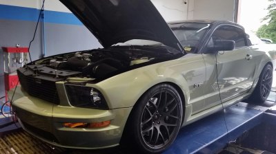

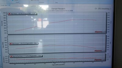

THE RESULTS ARE IN.. and I'm not disappointed. Car is tuned for 93 Octane, and it still has some breaking in to do. Very small amount of glitter in the oil after 600 miles. It should get stronger over time. I'll just stay after the oil changes.
