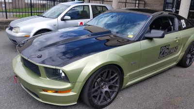

Fiona (big, green, and badass) in AutoX trim with my son's GTI. I like that GTI so much I've been spending my time trying to bring my other GTI parts car back to life. New turbo is happening now (old one had more play than Lindsay Lohan). A couple of side mirrors and new tires w/ alignment will make it streetable. I may just daily the bashed up 200K mile POS for the fun of it. I'll run it in a few AutoX days to see what it's like to toss the smaller car around the cones. Should be fun.
