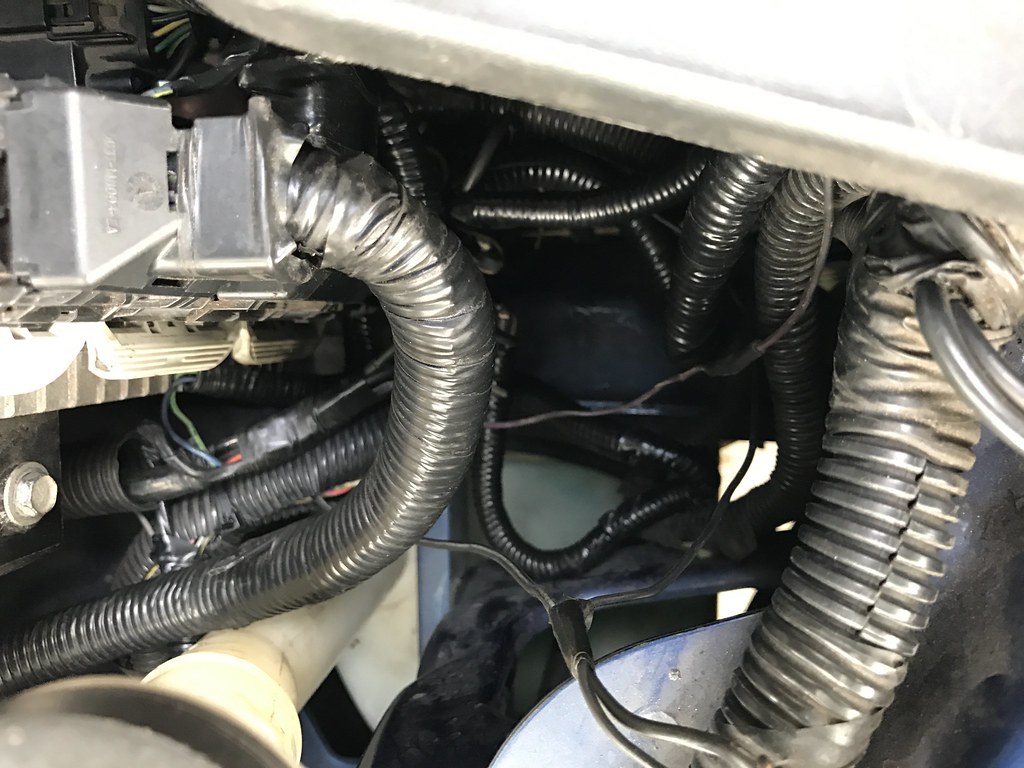

Swapped intake cams on the car today. No more F150 intake cams. The car definitely pulls harder now and will actually do something past 6K RPM besides make noise. The cam swap wasn't nearly as bad as I was expecting. A little time consuming, but it seems almost impossible to screw it up. While I was in there, I almost replaced the F-150 oil pump with a Mustang pump.
I may go work on cleaning the wiring up some more tomorrow. I wanted to do it today, but I took too long on the cam swap. Ignore the two random wires, those are trans related and will be gone once the MT82 goes in. I didn't want to spend the time wrapping them up if they were just going to come out in a couple weeks. I wish I had some before pictures.

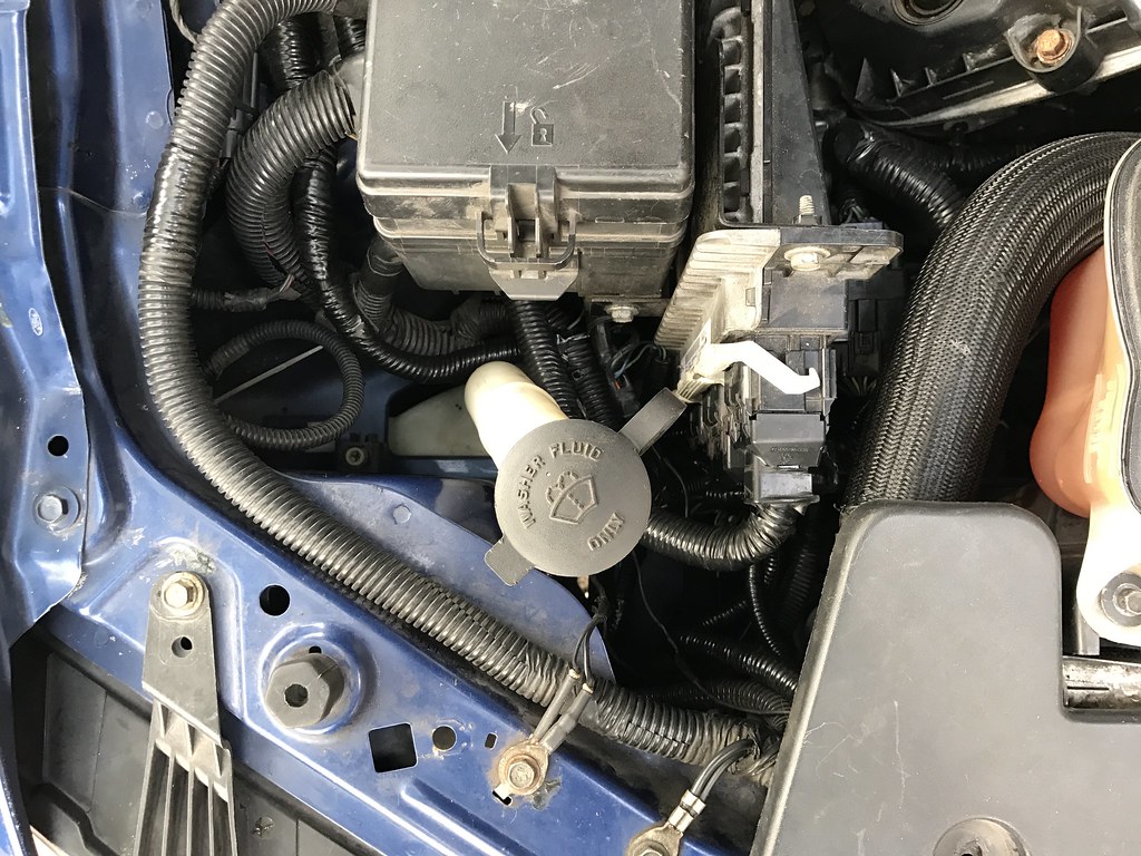

Did some more wiring today. I think I'm going to leave it alone now. i'm pretty happy with how clean everything is now. There are some things I may revisit in the future, but there really isn't much more I can do without really ripping the car apart.
The AC was rewired, so no more wire running down the drivers side and no more relay under the hood. As soon as I get a revised tune, the AC should be working again. The accelerator pedal was wired into the existing 3V body harness, so I was able to remove that jumble of wiring running around the engine bay. The reverse light wiring was hidden a little bit and I may try to find another way to run it. Speed sensor wiring will be removed soon with the MT82 swap.
I miss the black intake manifold, so I may paint this one black.
