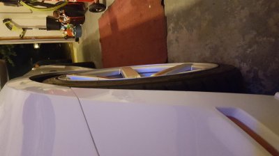

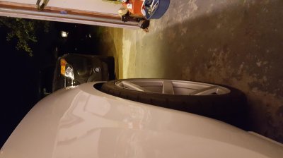

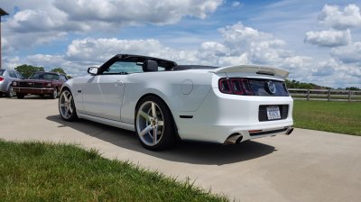

heres some pics I just took of mine to show how deep the concave is and how far they stick out. and some pics of my sgt I had the same wheels on.
well for some reason it will only upload the pics sideways
