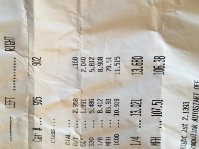

Yesterday was the first time I took my 2007 GT 5 speed to the track. Wondering if anyone can help me out with understanding where I should be improving, or how much time could be improved with more seat time.
Mods to the car:
LCA's, 4.10 gear, JLT cold air intake, off-road pro chamber.
My time is from the right lane.
Any information, tips, or advice would be greatly appreciated.

Not bad reaction time. Am pretty new to the track too. Just went Friday for the 2nd time. Am learning most of it is seat time and trying different RPM launches. What PSI are you running on your Tires? I am street tires and 50 PSI in the front, 25-27 PSI in the rear. I found no different times on my tires weather was 27 or took down to 25 in the rear.

Not bad for a first time out. Depending on what tires you have on the rear you can trim that 60' down, good times are all in the 60'. Your mph is good for 12's.

Tires are the stock 245 x18 Pirellis. I changed nothing with the air pressure, so I'd guesstimate about 35 PSI. Is there any tips on getting the 60' down? I'd love to be able to run 12's even 12.9999 would be fine be me. I tried launching at higher rpm's but would just spin. Wasn't the easiest thing to watch the tree and try launching at a consistent rpm. I guess I just need more and more practice.

Only tip I got at the track that seemed to work really well was to leave on the last yellow. My first reaction times were like .600! I had about 5 runs in and they all were within .2 of each other. What would a good 60' to shot for with this setup?

If your just spinning and your rear tire 35 PSI, they need to be lowered so there is more tire contact. Lower the PSI to 25-27 and that should help with the 60ft. On street tires are you going around the water box? As you should do a dry burn out on street tires and not go through the water box.
