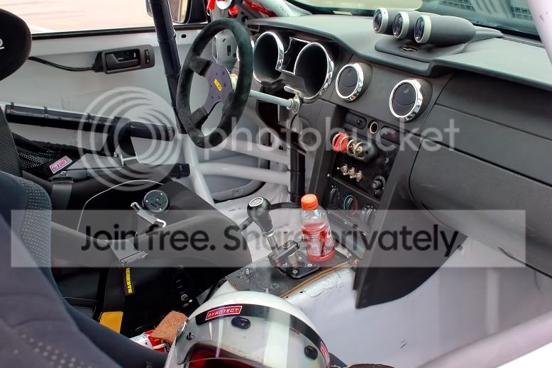

Agreed, the stock seat really does kind of suck when you start going faster. I was looking for a track pack car if only for the recaros and rear diff but I never could find one with a glass roof. Plus I daily drive this car so I'm reluctant to go all aftermarket race seat and airbag lights, etc. I'm thinking about taking it to an auto upholstery shop to see if they could build me better bolsters using the oem seat, maybe that would be a reasonable middle ground improvement.
Wasn't there some sort of drop-in padding that would provide similar lateral constraint function?
A separate non-slacking strap may also help. Tends to keep at least the lap portion of the OE 3-point belts from going slack, and seems to be acceptable to tech inspectors. Old seat belts cut a little shorter, stitched together, and wrapped around the back of the seat cushion will work. The stitching need only be strong enough to withstand somewhat more than however much static tightening you're willing to subject yourself to, doesn't have to be pretty.
