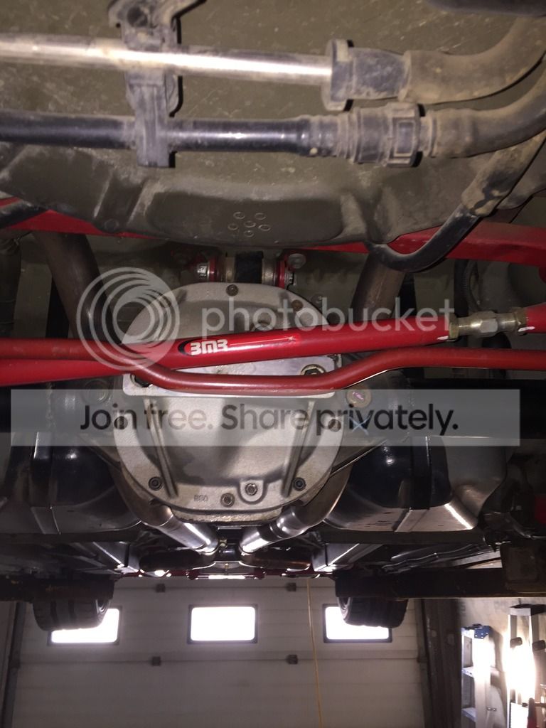

I got the knockoff version of that and it clears my J&M aluminum PB by a half inch or so (installed).
However I will say it was a little tricky to get over the ring gear during installation with the panhard bar in place. It can be done, it's just easy to mess up your silicone trying to finagle it into place.

I have the finned frpp diff cover with Whiteline Adjustable Panhard bar and lowered 2" on coil overs and have no clearance issues.

It clears, If you want to go to AMs web site and look under driveline there are customer pics with them installed.

Just be smart and unbolt one end of the panhard bar before swapping the covers. It will clear by about 1/2" when done.
I had a Drake on the Bullitt but same clearance as the FRPP.
