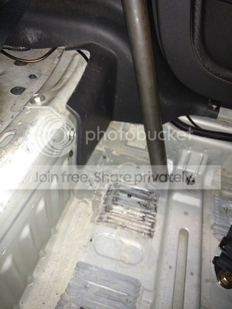

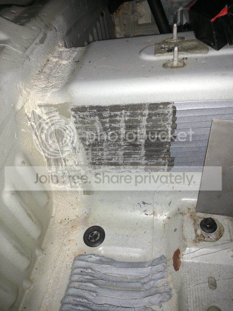

Next, I spent a couple hours scraping that sound insulation crap off the floor where the 1/8" plates will be welded in. What a PITA!
Then started to mock up where some of the main bars will go and tacked them in. So far so good, it's not as bad as I was anticipating so far, although there's a lot more to go..
So far there's decent room to access the joints with a tig torch to weld them in. Wolfe located the joints in pretty accessible areas. The only ones that look like they may be trouble are the connections down in the kick panels. The only other issue is the rocker bars don't even come close to fitting, they're not even in the ball park. I'm gonna have to call Wolfe next week to ask them WTF. The only way those bars will fit is if I cut out the OEM seat mounting bars, which of course would then result in an issue when it's time to put the seats back in. Worst case I'll just leave those bars out, I'm thinking I will still pass NHRA certification without them since there is an OEM rocker frame type configuration there.

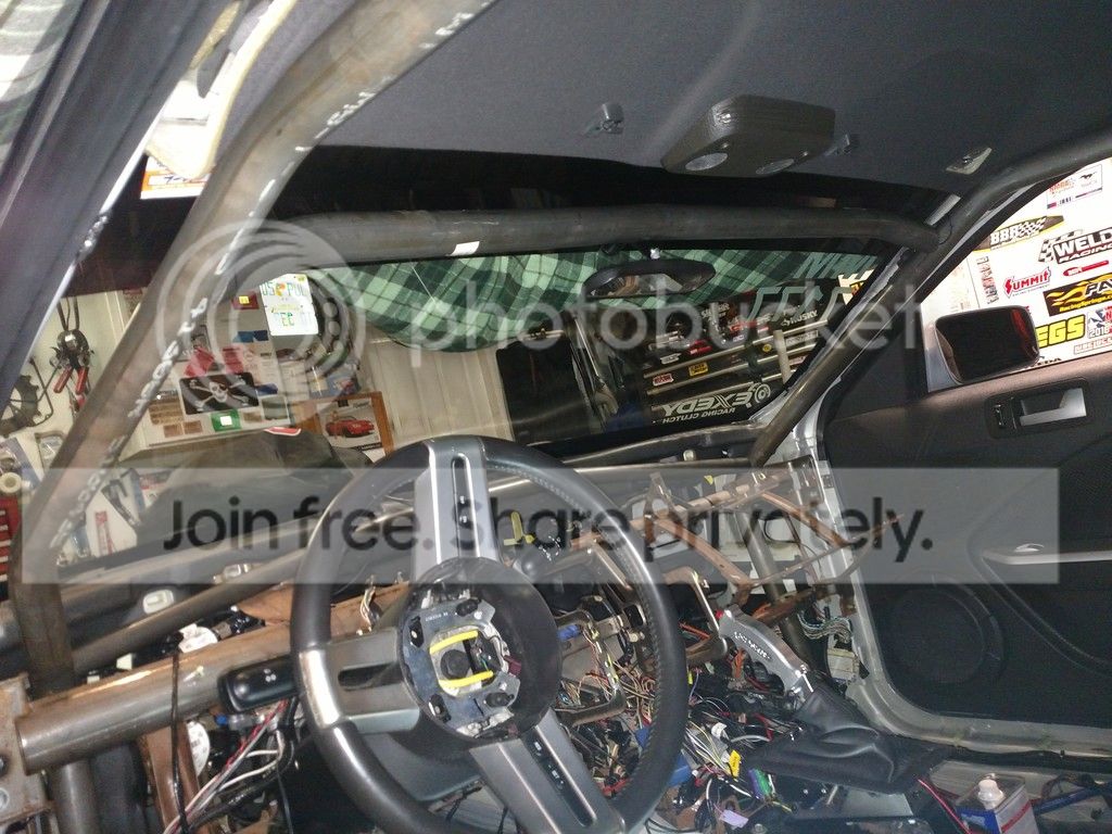

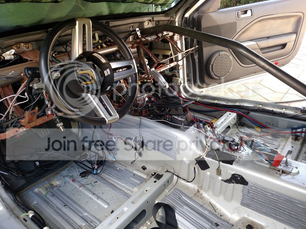

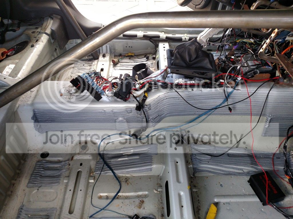

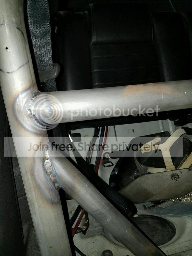

A little update on this project.. I made some more progress, welded in a couple of the floor plates and tacked all the main bars in place, then I quickly realized this shit is a lot more difficult than it looks! I can hold my own tig welding in position at the welding table but cramped into a corner of a car where you cannot see or reach shit is whole nother story! I decided to spare my car of my learning curve and brought it to a buddy today to finish it up for me. This guy recently installed and got certified a full 25.3 chassis that he built from scratch, literally, he bent and notched every single bar and it came out great, so I will have him finish up my cage before I eff it up. I try to do most everything to my car myself, but there are some things best left to people with more experience, and this is one of them.
Here's an idea of how the side bars will look though:
I should have it done and back in a couple weeks, will post pics of the finished result. Then it will be off to inspection to get that nice silver sticker on the side of the cage.

Holy wire messes. The cage looks great. Wish I could do this

Yea tig in tight places like that is a real art. Flex head, short back stem, adjustable on the torch make it easier but still an art. I'm the same way, I hate to have other people working on my car. I'm no good at body work so I do have a body shop that's great.

lol. Yeah those wires would give me anxiety.
Are you gonna organize them and rewrap them as part of your build?
If you do, how will you do it?
Yes actually I already did that, after those pics, before I brought my car to my buddy's shop. I removed some that are no longer needed, and re-ran some others, mostly just zip tied them together as neatly as possible. I don't want to wrap them in anything in case I need to access them in the future, unwrapping is a PITA.

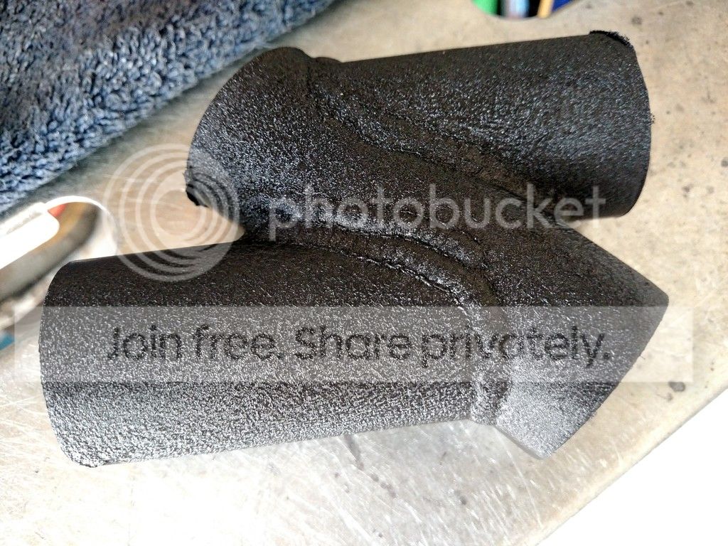

My car should be ready to pick up on Monday, then I get to paint the cage and put it all back together, and get it inspected and certified, but not necessarily in that order. I picked up a can of VHT black wrinkle paint and tested it out on some scrap tubing, I think it will work!

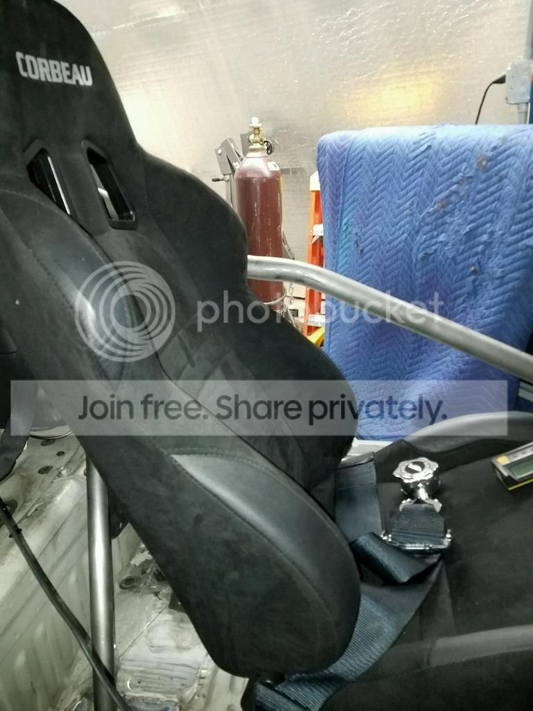

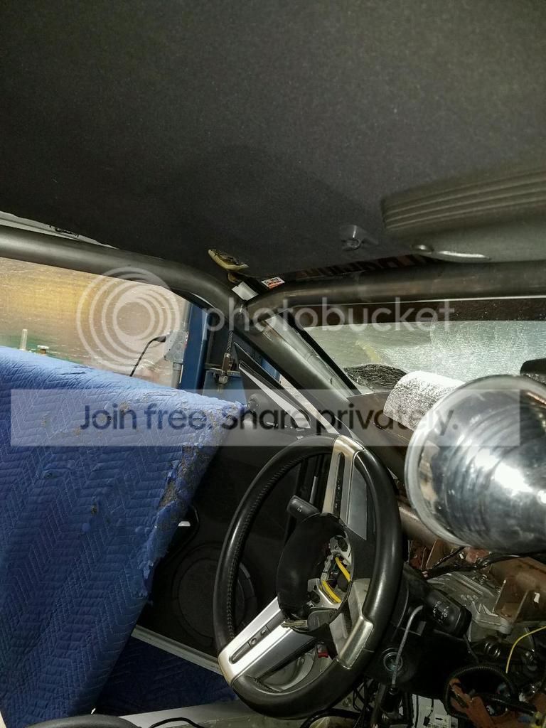

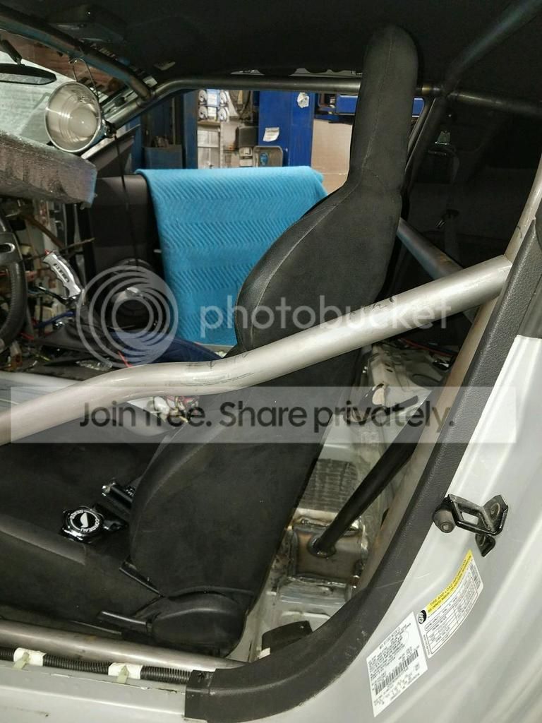

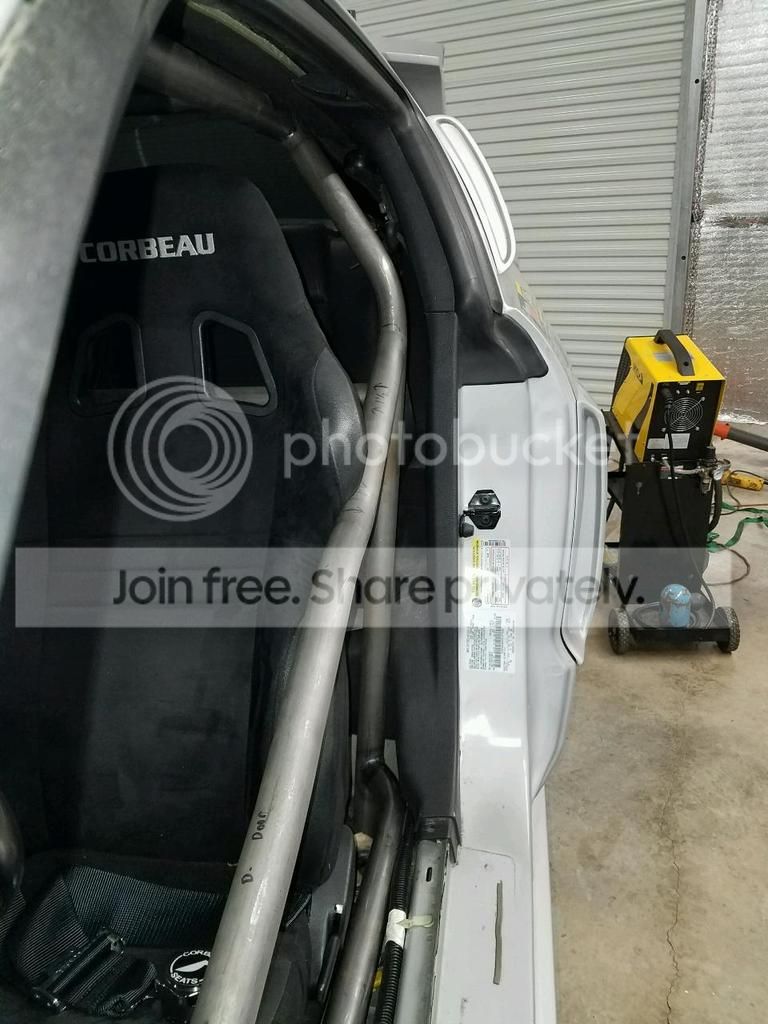

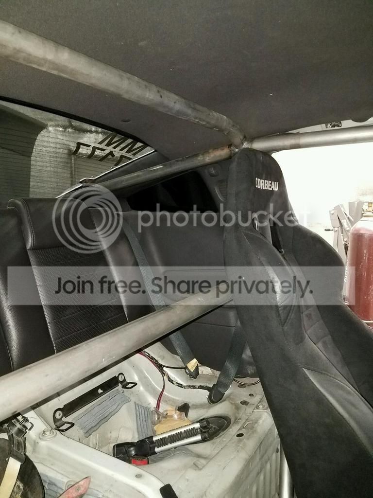

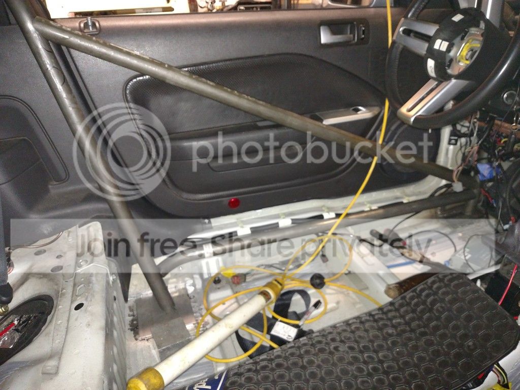

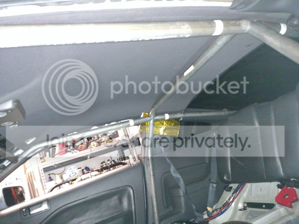

Here's a few progress pics, it's almost done now. I should be able to bring it home by the end of this week. We ended up bending the door bars to allow for more clearance on the seat backs. The NHRA inspector says it's okay to do that.
