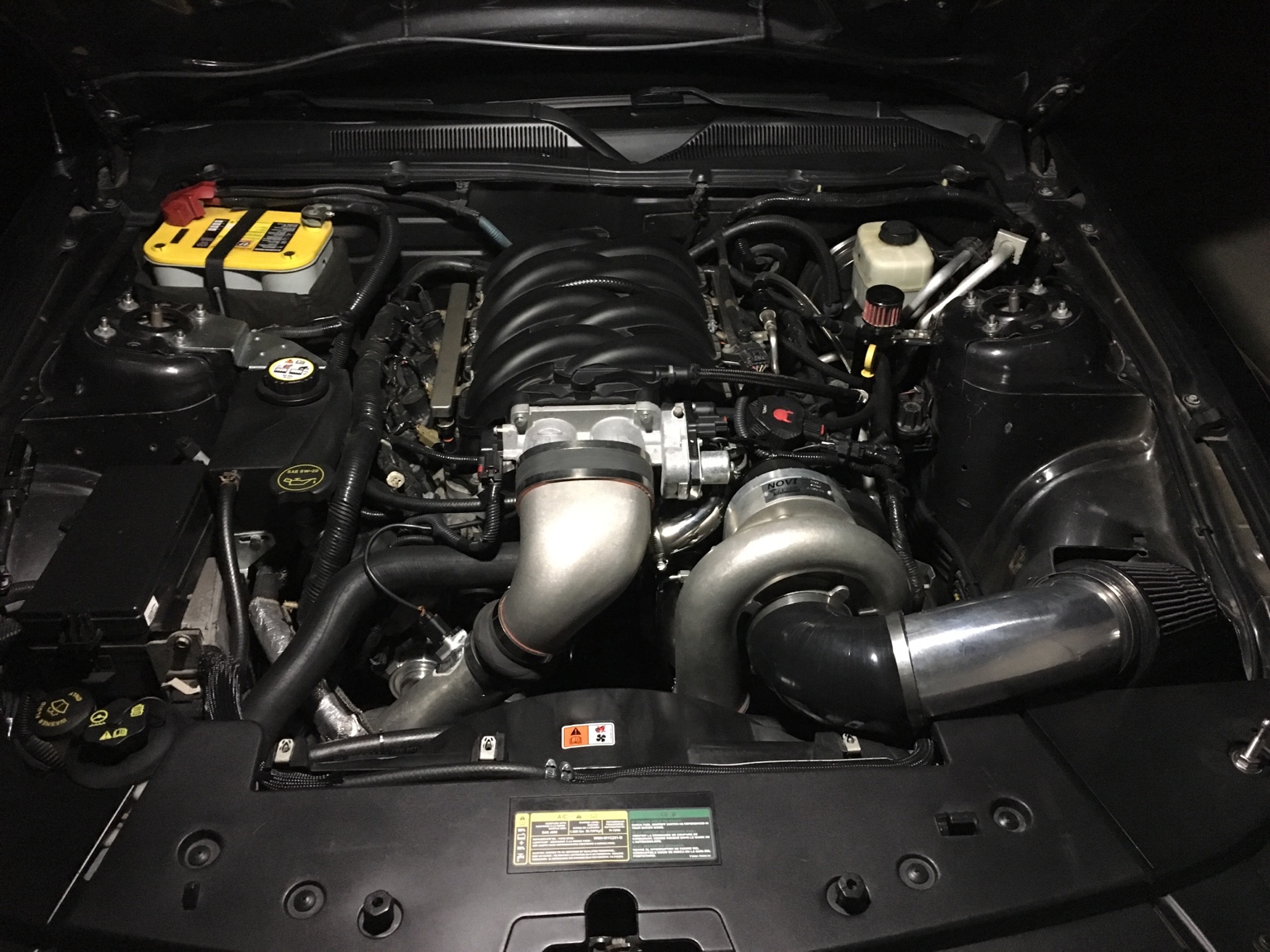

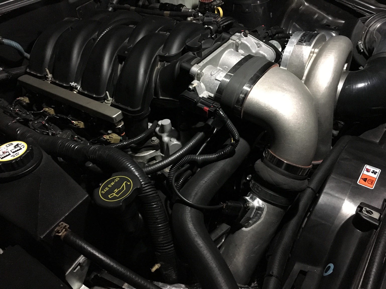

I just don't like how the Paxton coolant tank is sitting on top the headers.
Does anyone have any suggestions to relocate the tank to the original stock location or something similar?

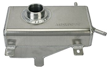

Do you guys think the moroso tank will fit?
Moroso tank looks slightly smaller than the OEM plastic one:
Picture of my engine bay as reference.
The OEM tank almost fits but it hits the charge pipe.

I used the factory tank on my 2010 with the Paxton but I did custom piping to make it work. I have a Canton tank I tried but that didn't fit either without custom pipes. The issue is the angle that the aluminum elbow off of the TB needs to be about half of what it is now or the tank hits it. I looked but didn't find any pics of mine installed as a reference. I used a 90* 4" to 3" silicone elbow in place of the aluminum elbow and made a new pipe to connect to it.

I ordered a Moroso tank from amazon got it today but as someone already mentioned it doesn't clear the cast throttle body elbow. It's closer to fitting than the oem plastic one but still gets in the way. If I had cutting/welding aluminum skills I could chop off the corner and close it up but no skills.

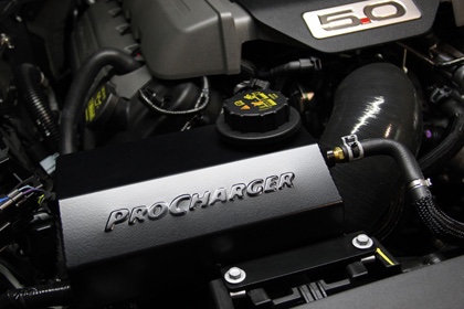

Now I'm looking at the Roush intercooler degas bottle.

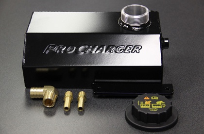

I know I wish it didn't say Procharger on it. It's almost $200 as well.
If it fits I guess I could grind the letters down lol

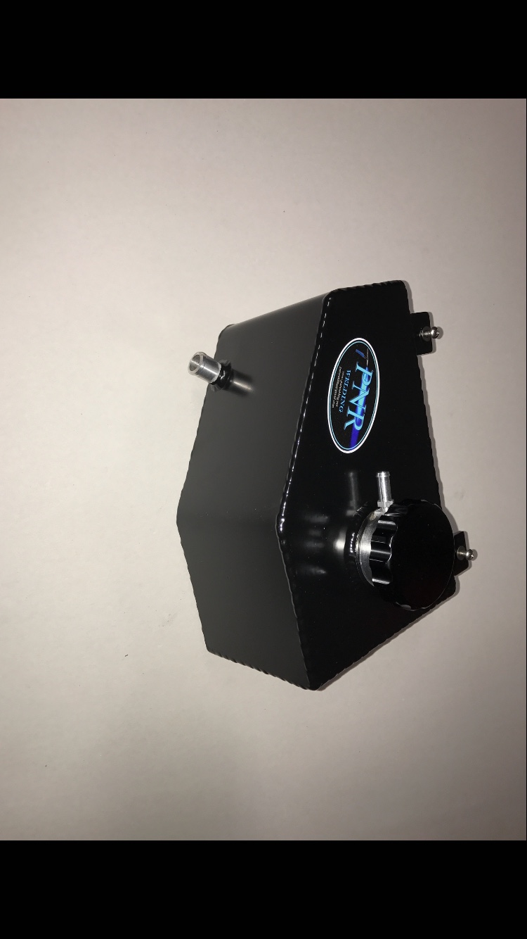

For those that relocate battery to trunk I make a coolant resevoir for battery location.
I can also make one to your specs. Powdercoated also.

Could you make one that fits the stock location but clear the Paxton piping?

I can only make one if you give me dimensions.
I don't have Paxton/vortech car around anymore.
