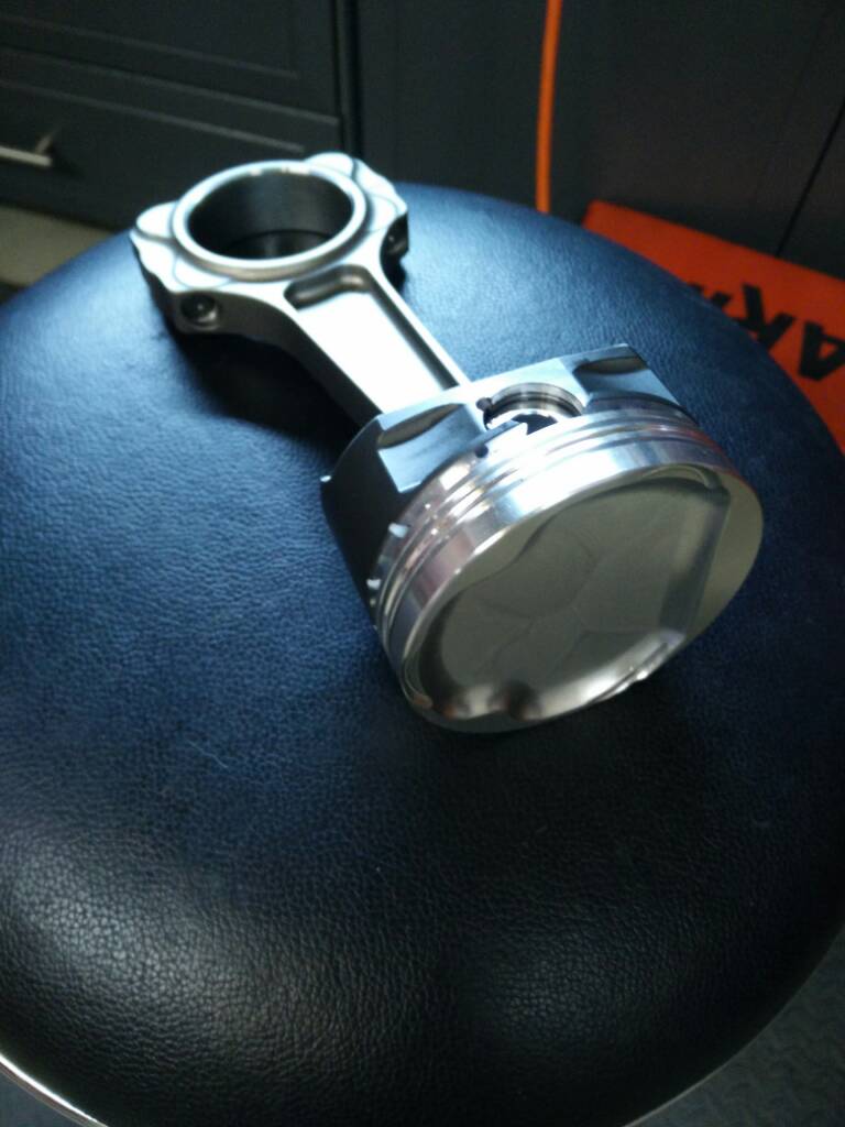

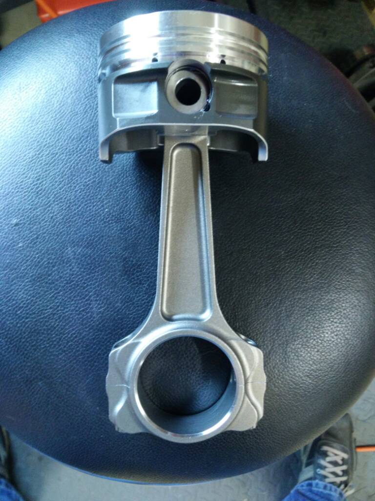

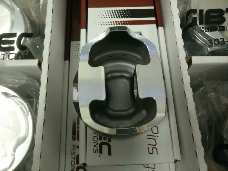

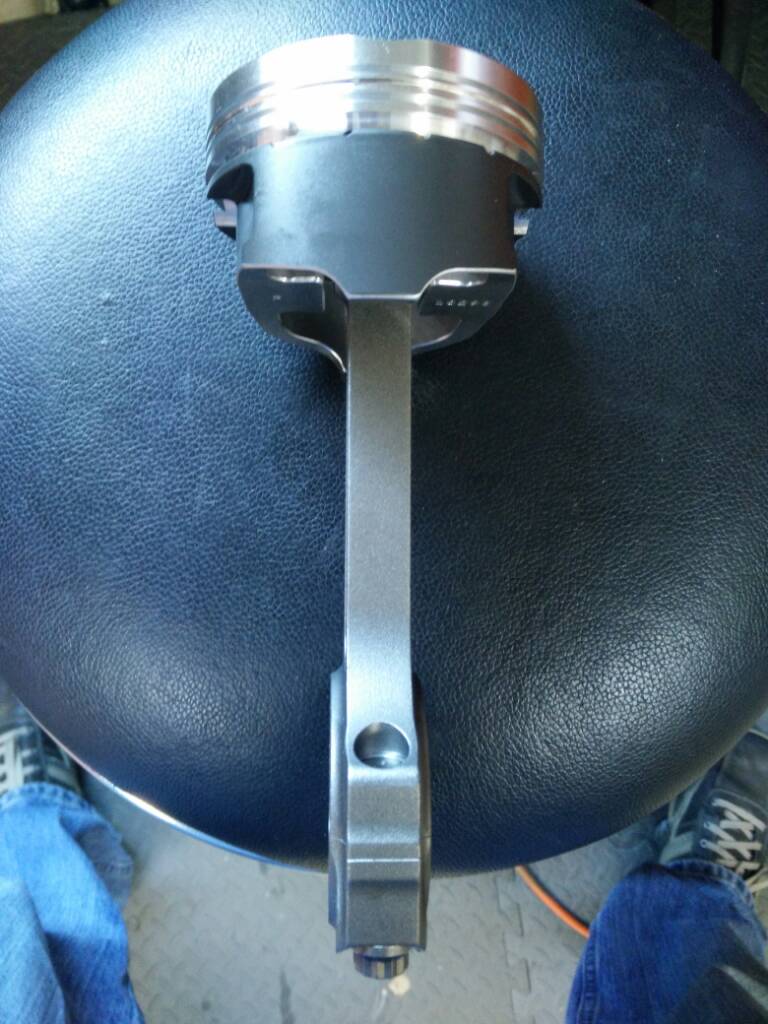

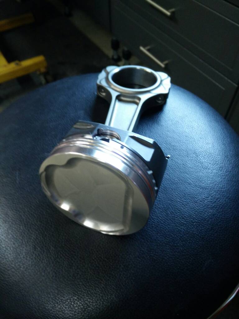

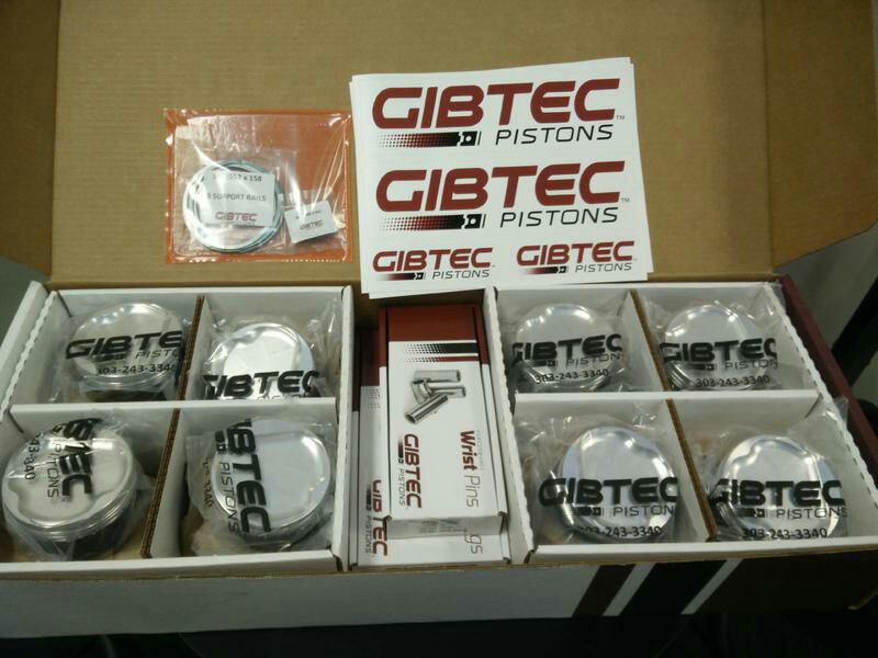

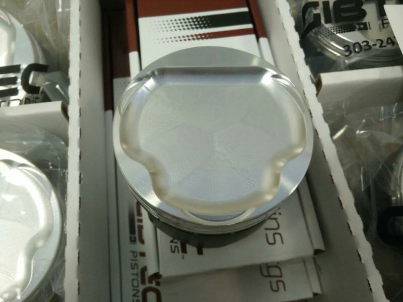

For pistons contact Nick at Gibtec Pistons in Denver, CO. 303-243-3340 They can make you a set of custom billet pistons for ANY application with ANY spec you want... Just ask. They will also come with upgraded wrist pins and Total Seal rings.
Here's the set I ordered. Price is very reasonable too.
Also search for "Aluminator Gibtec Build" for an incredible build thread on the Modular Fords forum.
Sent from my A0001 using Tapatalk
What does a piston weigh?
363 grams
The nice thing about these is they can make them any diameter, any ring package / stack height, any compression ratio, etc.... They are 100% custom built to the buyer's specs. You don't need to settle for standard over bore sizes, standard compression ratio's etc.
I had mine done with offset pin bosses, skirt coating, .200 wall pins, and a .25" top ring spacing, and a anti-flutter groove.

If you are in Denver you should go to the Gibtec facility to check it out, it's actually in a bigger building / business called Western Motorsports. They also can make custom rods, cranks, etc. It's clean like a hospital with gobs of machines and piles of billet stock.
When they made my pistons I brought my cylinder heads down and they digitally scanned them to get the combustion chamber shape and valve reliefs etc.
