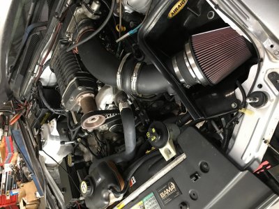

I just had a Ford racing Whipple supercharger put on my car everything works fine but the mass airflow sensor is reading -7 degrees Fahrenheit . We've changed sensors and it still reads the same temperature. We've checked all the wires and everything set up correctly but still cannot find the source of the false reading. Help!

It really sounds like either the wiring, connector, or maf itself is having an issue.
There is a parameter in the tune to modify the reading but I just can't see anyone doing that.

I worked on one of these not to long ago and it was the maf extension plug that came with the kit you could move it while connected and it would read right. I went ahead and located the temp sensor to the intake manifold problem solved.
