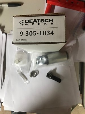

Looks pretty straight up to me. Here's what's in the box. I was told to swap in the new pump and whatever else in the box and put it back in. It's a 340LPH pump.

Super easy. Undo a few bolts. Cut the hose from stock pump, slide that up and reconnect

Thanks for confirming. Looked pretty simple (maybe not EASY but simple) to me.
Should run this weekend if we did everything right.

It's best to do it with under 1/4 a tank or so.

Also it may help to unbolt the tank straps on either the front or back of the tank so you can drop it down a couple of inches. This really helps with the angle Ford put in between the pump and the access hole. They are offset so it helps to have a little extra wiggle room.

No you use the same hat, keep the level sensor. Your just swapping the internal pump
