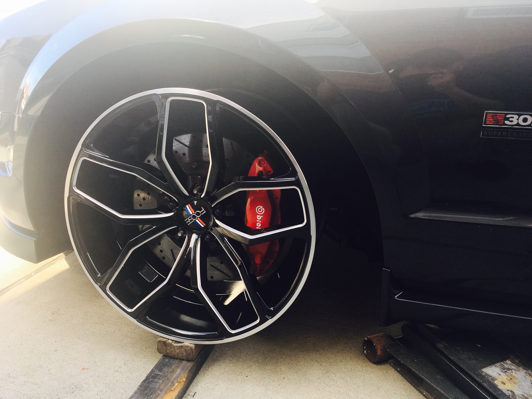

New wheels just showed up and I test fitted the 20x10 40mm up front and it clears the brembos and just made my decisions harder to make.
I'm not buying new tires so let's leave any other sizes out.
I currently have 255/40/20 on 9" wheel and it's perfect for me.
My new wheels now I can either run 8.5 or 10 up front.
