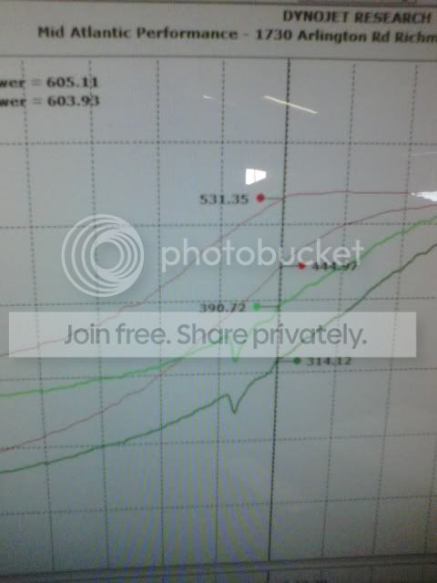

Got out to the dyno today at Mid Atlantic Performance in Richmond and let Mike Rousch work his magic. Had to get the tune tweaked for the new turbo and the driveability issues fixed.(last time i was on the dyno i had bad 02 sensors.)
Old turbo was Precsion cast wheel 67mm. And the new turbo is the same 67mm size with a billet wheel.
So, first off backed off the boost controller to get the boost back down(at the same boost controller setting the new turbo was making 2-3 more psi) New street tune at 11.6 psi 550rwhp 510rwtq only pulled to 6000rpms would have made a little more power if we spun it higher, but no need, a/f was good and we wanted to turn up the boost. :)
(old turbo made 563rwhp 516rwtq at 12.1 psi reving to 6500, so similar numbers)
Next were the shocking results!!! Bumped it up a few psi with the boost controller and at 14.6 psi made basicly the same power numbers up top at the exact same boost level as the old turbo.(old turbo 603rwhp , new turbo 605 rwhp) So we overlayed the old cast turbo pull and the new billet turbo pull and we were shocked! At 3800 rpms the billet turbo was up 130rwhp and 141rwtq! Huge gain in midrange and spool! From the start of the pull from 2,000 rpms the billet turbo is already up 30hp/tq and just climbs from there!
Old vs new peak numbers (603 is old, 605 is new)
Old turbo 14.6psi pull in green, new turbo 14.6 psi pull in red. (from 5,000 rpms and up the graphs even out, but from 2,000 rpms to 5,000 rpms the billet turbo is murdering the cast turbo in power and torque output!)
Badass!, why not crank it up a lil more? lol added another 10% to the boost controller duty cycle and made 16 psi, final numbers 655rwhp 582rwtq!
Called it a day there! Thats about the most boost/power I want to run on pump gas (93 octane.)

That's a real nice increase in power in the midrange, looks like the billet wheel was worth it. I bet traction is even worse now, lol.

Haha, yeah i could feel the low to mid power increase immediately on the street before i even got these results, its nice to see I was right. And yeah thats why I have dr's and can lower the boost lol. It hits hard!

No theories here, Compressor map, compressor map, compressor map! Its not just a billet wheel turbo(yes it is a one piece ie billet design, but thats not where the gain is from) its a completely different impeller design. With a completely different compressor map/efficiency range compare to the cast wheel design. The billet wheel boasts the midrange of a much smaller turbo wheel with the max power range of a much bigger turbo wheel, the best of both worlds. Ar housing has really nothing to do with the efficiency range of a turbo. AR size is important to match up for the size/displacement of the engine and the max/boost power you intend to run as i stated above.

Sorry man, you are way off. Your are mis-interpreting, ar exhuast housing size will not effect the compressor wheels efficency range (compressor map). It will just start turning it a little faster, sooner, and in turn have more back pressure which will slow it down a little up top as well.
A turbo's efficency has to do with the compressor wheel design, the ar housing on the turbine wheel is just a small part and is more important to match to your setup, ie exhuast flow.
Shit if it were that easy we could make $200 dollar ebay turbos work wonders with just an ar housing swap.
I will quote directly from your link so you can re-read it.
Turbine A/R - Turbine performance is greatly affected by changing the A/R of the housing, as it is used to adjust the flow capacity of the turbine. Using a smaller A/R will increase the exhaust gas velocity into the turbine wheel. This provides increased turbine power at lower engine speeds, resulting in a quicker boost rise. However, a small A/R also causes the flow to enter the wheel more tangentially, which reduces the ultimate flow capacity of the turbine wheel. This will tend to increase exhaust backpressure and hence reduce the engine's ability to "breathe" effectively at high RPM, adversely affecting peak engine power.​
Turbine ar size has to do with performance, ie spool rpm and peak power, not compressor effiecency, two totaly different things!
Again, I saw no gain going from .91 to .81 ar housing on the same cast 67 impeller wheel. I never tired the .68 on the old turbo but the reuslts would have been similar, small gains in intial spool rpm. One eye willy tired a .68/.71 on his steup and saw no noticebaly gain so switched back to a .81.
Anyone that works with turbos knows these results are no where near possible by just changin the size of the ar housing. It will not radicley change the compreesor wheels efficiency curve. The ar housing is important to use the exhuast flow available, its a fine balance between too much/not enough back pressure one way will help spool alittle and hurt max power output. And the other way will spool a little later but make a little more peak power.​
Yes on both the old and new pull I have datalogs of the boost by the dyno's sensor. Mike Rousch shop's internet is down so as soon as it comes back up he is going to email me my graphs and I can post it if you would like to see.​
As for the new turbo tune, the first pull at 12 psi was lean (12.6 ish so he lett out) he added wot fuel to bring it back down to 11.8. That the only tune change. There were no other mods, same intercooler.​
Not trying to trick ya or hurt your feelings, just posting the facts. It obviously not impossible to pick up the gains I did, well because, I did!​
