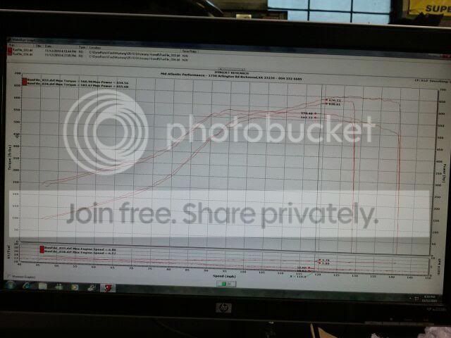

I will try to email you the dyno sheets from my phone again...
Got it Greg!
Here is the full size pic of the 16psi pulls that Greg took on his phone. Still not the best quality till i can get them emailed to me but you get the idea.
First pull was a little rich and let out at 5900, second one cleaned up air/fuel and pulled to 6500 and that was that! I gota say Im very impressed with Mike's tuning, he quickly calculates the percentages and is usually spot on the first try then just tweaks it in. Only needed 2 pulls to dial in the 16psi setting after bumping it up from 14psi!

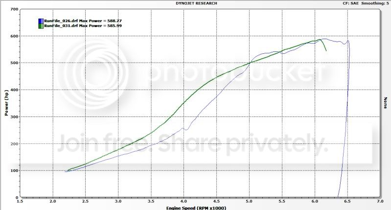

Got a bunch of my graphs today. Heres antoher at 14psi, blue line is cast 67mm and green line is billet 67mm.

that layover charts looks awesome man! Look at the power pickup through the midrange!!

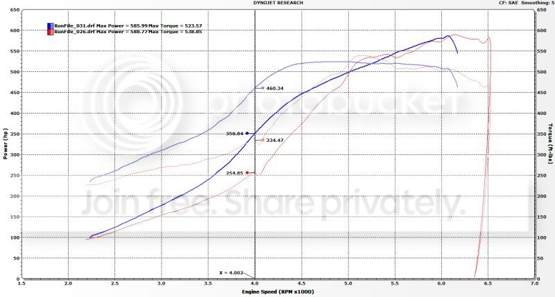

Heck yeah! Just figured out how to display torque too.
At 14psi at 4,000 rpms the billet is up 100rwhp/100rwtq!
