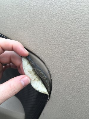

What's the best way to get all the glue off if it is still sticky? I've done a few quick spray repairs to get it to stick. I'm starting over! There isn't any of the dry foam left. Just what the leather panels adhere to.
I've had good luck with GooGone getting glue residue off. You'll just need to make sure to clean REALLY good because it will also stop new glue from adhering properly.
coreystang
Sep 24, 2010
73
Shreveport, LA
So before I start tearing everything off. I am taking off the middle piece off and not reusing it. The new panel is going right on the plastic part. With nothing in between.
