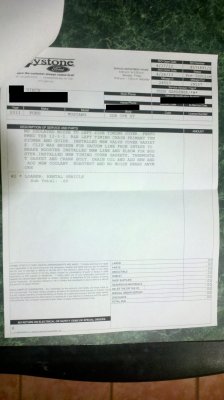

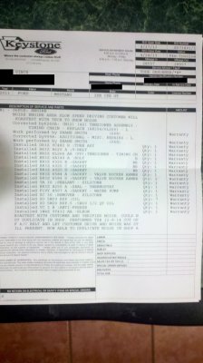

5.0L ENGINE - METALLIC RATTLE OR SCRATCHING TYPE NOISE FROM FRONT OF LEFT HAND CYLINDER HEAD AT IDLE - BUILT ON OR BEFORE 3/31/2011
There have been several updates on this TSB, which affects the timing chain tensioner. I took my car in because it was making a godawful noise after it warmed up right off idle, usually heard as the engine's revs were dropping back to idle after being revved slightly, such as when doing low-speed parking lot maneuvers. The only way to describe the noise was that it sounded like a "CLACK-CLACK-CLACK, CLACK-CLACK."
It was BAD.
I have attached the latest TSB for this issue (12-03-01) and pictures of my service department invoice.
Get this done under warranty if at all possible. It's 6-8 hours of labor and a LOT of parts.
