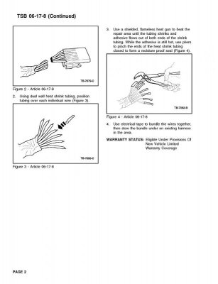

06-17-8
service Wiring Harness Replacement Guidelines - Service Tips

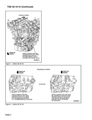

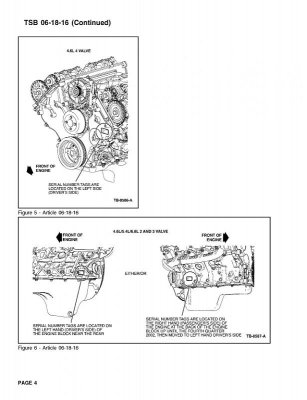

06-18-16
identifying The Correct Replacement Head Gasket For Certain Remanufactured Engines - Service Tip

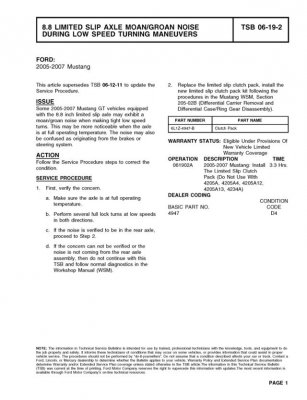

06-19-2
8.8 Limited Slip Axle Moan/groan Noise During Low Speed Turning Maneuvers

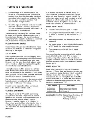

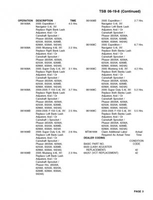

06-19-8
Ticking And / Or Knocking Noise / Startup Rattle From Engine - 4.6L / 5.4L 3V

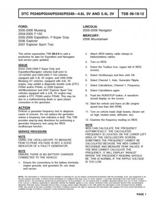

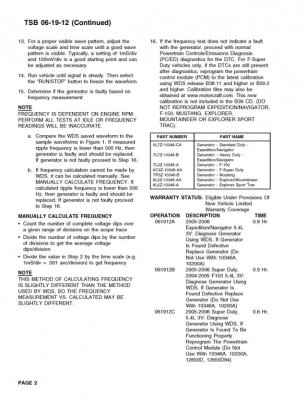

06-19-12
Dtc P0340/p0344/p0345/p0349 - 4.6l 3v And 5.4l 3v

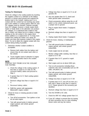

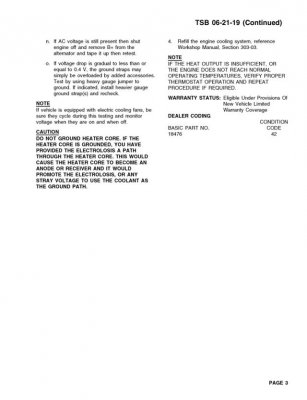

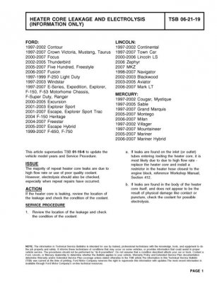

06-21-19
heater Core Leakage And Electrolysis (information Only)

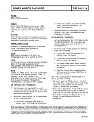

06-22-18
power Window Diagnosis

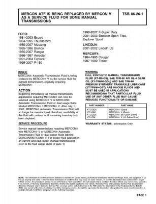

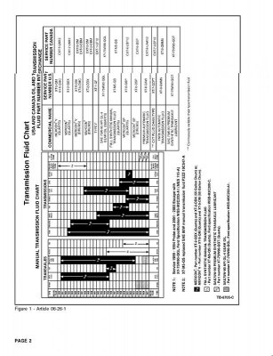

06-26-1
mercon Atf Is Being Replaced By Mercon V As A Service Fluid For Some Manual Transmissions

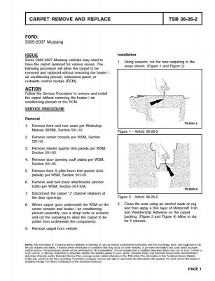

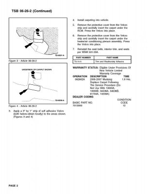

06-26-2
carpet Remove And Replace
