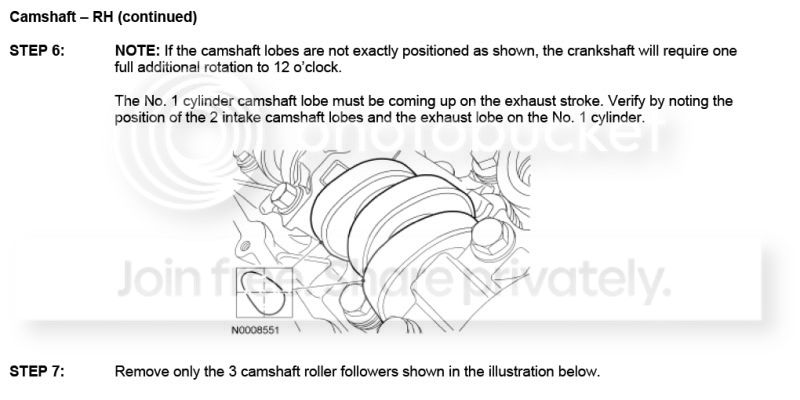

Sherrod, I have done 3 cam swaps and never used the spring tool to remove followers. We did it the same way as the video except in the ford tech manual in shows you how to align the cam before removal so you have the least amount of pressure on the springs/followers, thats what we did. Worked fine. The cam is keyed to the phaser sprocket. So as long as you orient the new cam the same way the old cam was and then mark the chain/phaser and put it back the same way it will only go togther one way. The front of the cam has a key on the bottom just like a crank pulley. You use the physical placement of the first 3 lobes on each side to tell. Also, doing one side at a time makes this way easier.
Here are fords instructions and pics of what I'm talking about.
http://home.comcast.net/~cookpaging/hammeron/cams/misc/FordCamInstall.pdf
Driver side orientation
Passenger side orientation
