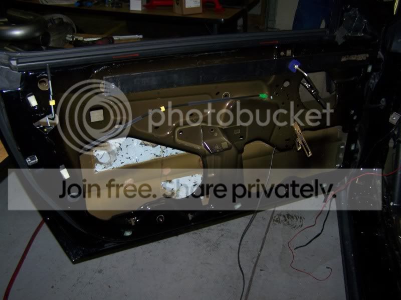

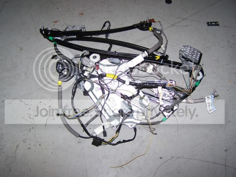

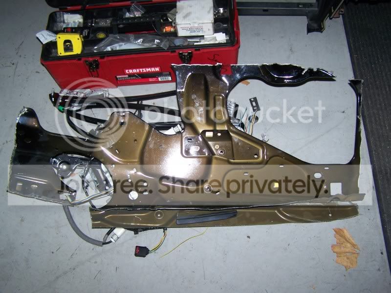

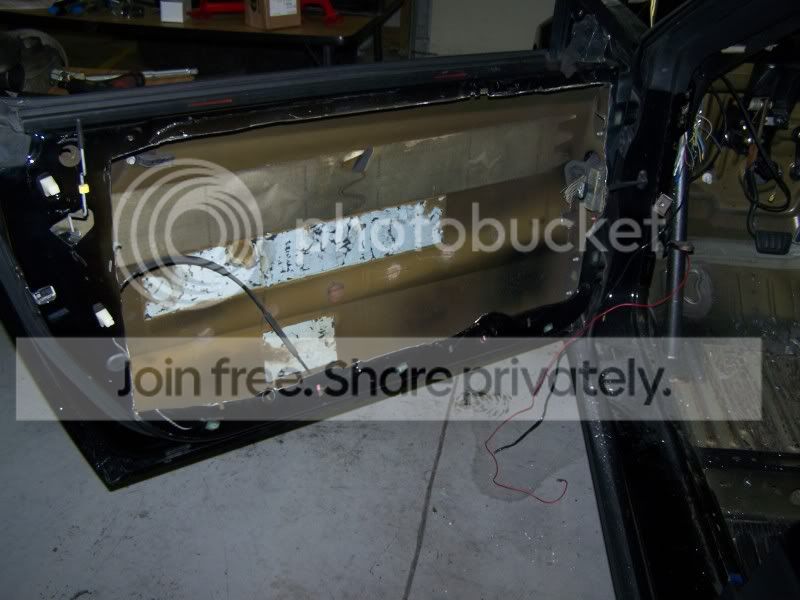

The haters are gonna love these pics.
I had previously cut out the crash brace. The window glass, window track, window motor, and mechanism have been removed. The piece of steel bar stock is being used as a straight edge for the plasma cutter.
I left enough material to re-mount the factory door panel.
I saved a total of 45 pounds today. A small amount of that will go back in when the Lexan is installed.

Can you do me a big favor and pay attention to how much the factory glass weighs that you remove, and how much weight the Lexan saves.
I supposed you are replacing everything with Lexan, including the windshield, backwindow, in addition to the door glass?
