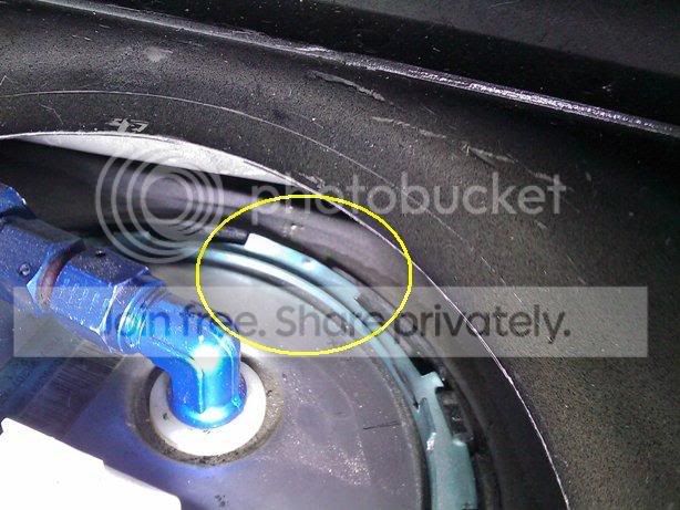

I broke into the fuel tank tonight. The wiring seemed to be OK. But look what I found...
The lock ring wasn't fully seated. I fixed it, which is a bitch to do with only two hands, and I'll drive it for a while and see what happens. It seems logical that the computer wouldn't read the correct fuel pressure if there's an air leak in the system.
I noticed that when I blip the gas, the fuel pressure on my gauge doesn't dip down to almost zero before it goes back up. Now it only goes to 10 psi or so before it goes back up.
Hopefully this will fix me up.
