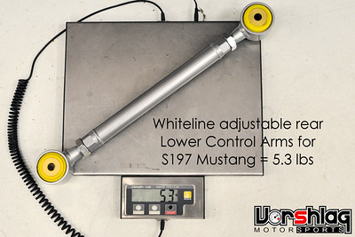

I'll weigh in because we've tried SO many different UCAs and LCAs on our two S197 test mules + customers cars we've worked on and tracked.
LCAs:
  • The stock LCAs are heavy, flimsy and come with super soft bushings. They can and do add to axle hop and a mushy rear suspension
  • Spherical bushings are great for a race car but suck on the street. Bang, clang, pow!
  • Typical polyurethane bushed LCAs can add some bind, but not nearly as bad as in the UCA arm position
  • We have installed various Ford Racing arms, Steeda billet arms, Whiteline arms and others.
  • The Whiteline LCAs work very well. They are adjustable in length, and don't add any bind to the rear suspension because of their "magic" bushings. Scoff all you want, but it isn't polyurethane. They are an elastomer that they've developed, not just the "red 95A poly" that everyone else uses.
  • An alternate LCA is a GOOD IDEA, and we recommend the Whiteline LCAs for both street and track cars.
  • While you are under there replacing this arm, don't forget the LCA relocation brackets! These are a low cost, high reward upgrade that adjusts rear suspension geometry that gets negatively altered when these cars are lowered (and they SHOULD be lowered).
Whiteline's bushing material is proprietary. I call them poly bushings because I believe that they use some sort of polyurethane. However, it behaves very differently than polyurethane.
Whiteline calls their bushing material "synthetic elastomer." It is basically a non-newtonian fluid. At lower speeds, it is more compliant and acts like rubber. This gives it a near-stock feeling when driven on the street. At higher speeds and shock loads, it is stiffer, making it behave more like polyurethane.
