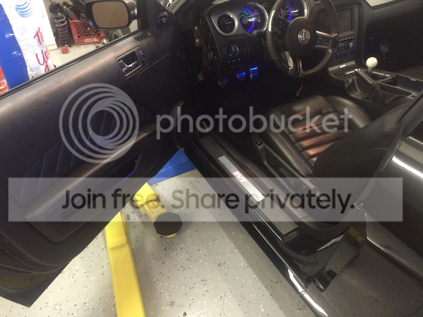

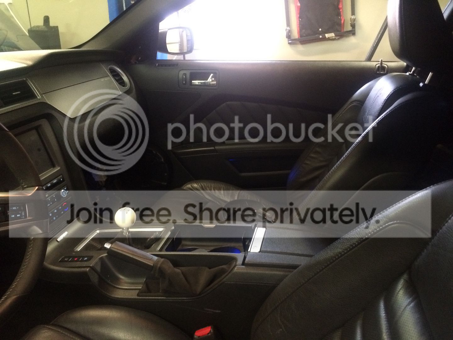

2005 GT doors on the inside with the 2011 dashboard, right? Looks good.
Jkoogler
Nov 14, 2014
265

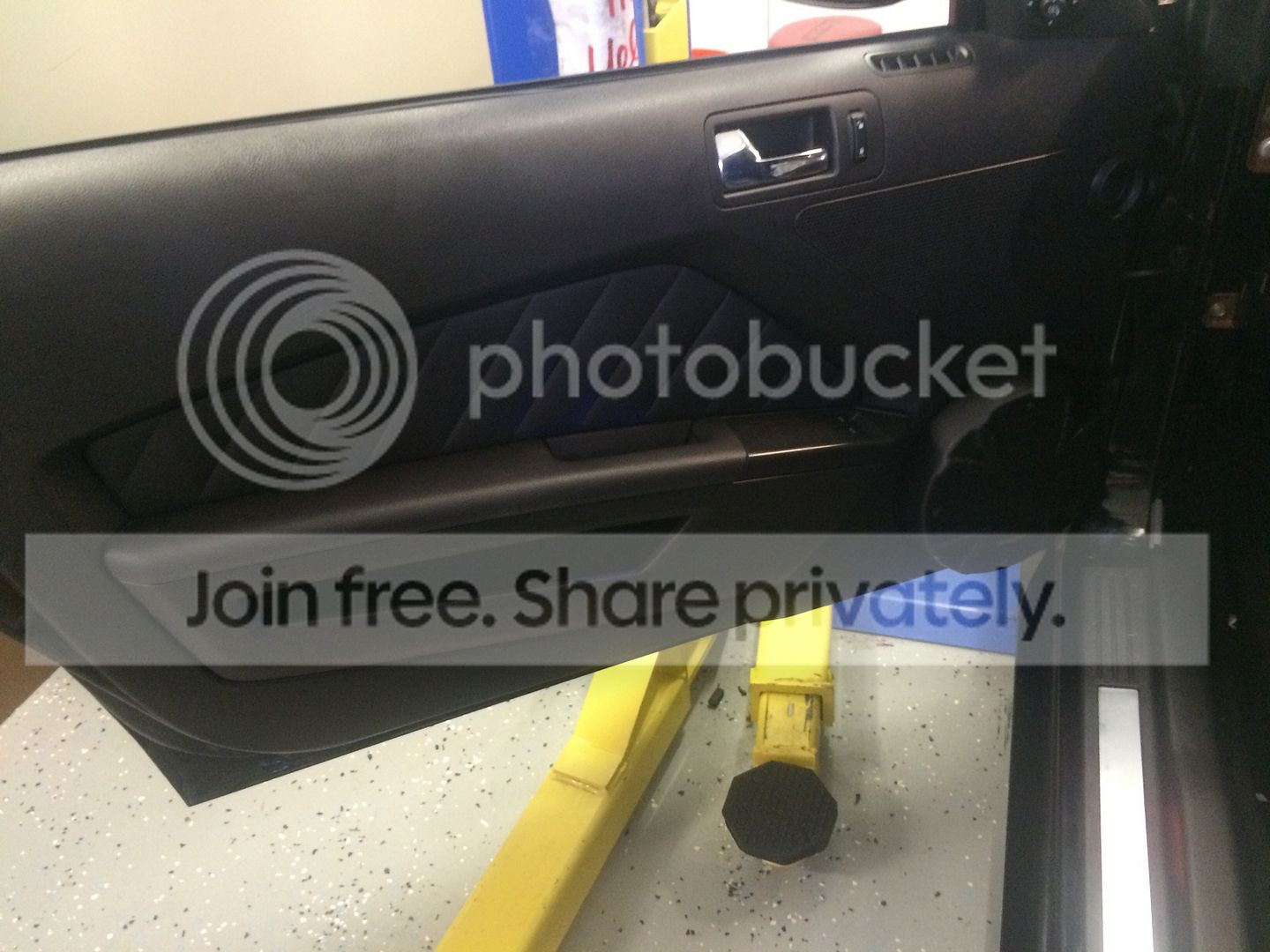

I took them out I installed 2011 door panels couldn't get the windows to work.

New doors installed I reused the locks and door sensors. Had to install new endow motors. You have to drill out the holes on 2011 motor but easy since they are plastic
